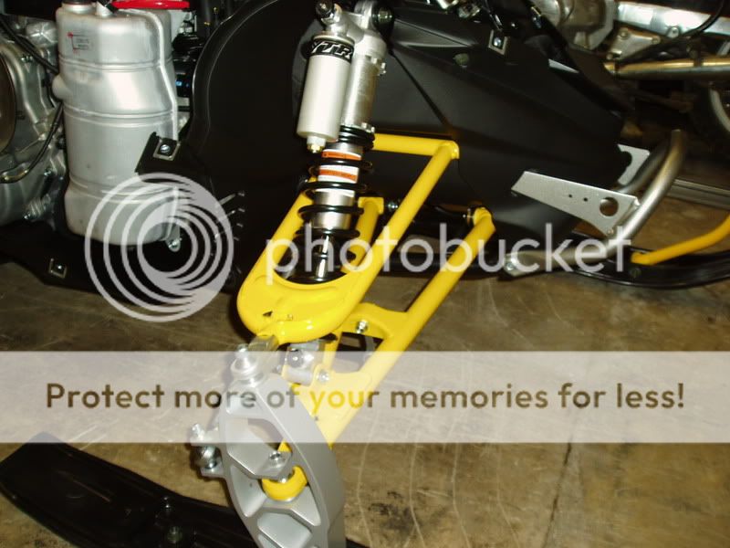

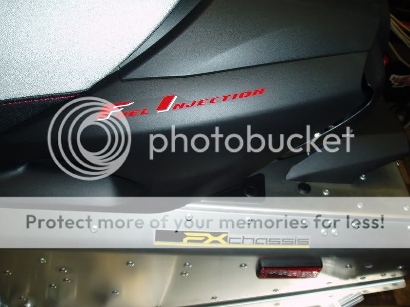

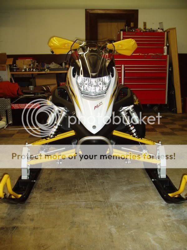

Just a few small changes I can see from prototype to production! This sled is gonna rock! Watch more posts tomorrow and through next week of 136" kit being added!

I can't wait for your clutch kit with these 136 tracks!
I have a couple questions:
Can the slydog (skis and wheels) be ordered multi colored as in 3 or 4 colors?
Could you please weigh the stock battery? (seeing how it's out)
Are you going to offer perfomance "packages" for the new FX Nytro? to include upgrades in clutching, exhaust, fuel management, etc?
Oh and nice looking sled! I'm sure it will be looking even nicer shortly!!
Thanks!!

Srxspec said:Just a few small changes I can see from prototype to production! This sled is gonna rock! Watch more posts tomorrow and through next week of 136" kit being added!

08NitroRTX said:Allen
Thanks!!
The Slydog skis can be ordered in multi colors, pretty much any design you want. The wheels I am uncertain of exactly as it is literature we just received and I haven't had a chance to talk to Slydog myself about them yet. I will have more information on the wheels next week.
The stock battery weighs 15 lbs and we already have a battery available that is 10 lbs lighter and should still work great in cold weather temps.
Performance packages will be available. Upgrades in clutching will begin testing shortly, exhaust system work is fitted and ready to go to the dyno (likely October for dyno time), and fuel & ignition management systems are finished already as well (just need dyno time).
NyTrOmAnIaC said:Any chance you can tell us exactly what you've noticed is different between prototype and production ? I'm sure there's more that are curious as well.
Mainly just some little refinements in the fitment of the plastic. There used to be a hook in the back of the side panels and it is now just a tab. Just some little refinements to give it that Yamaha quality!

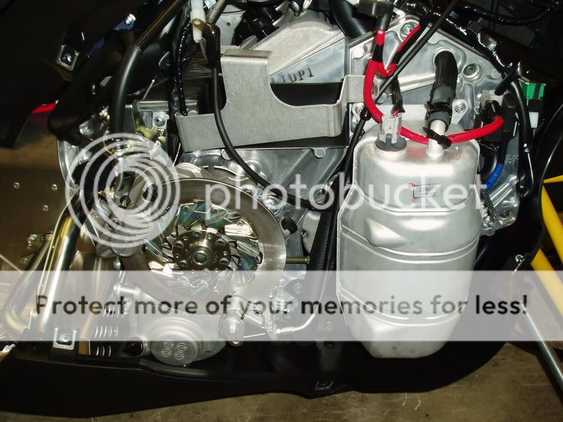

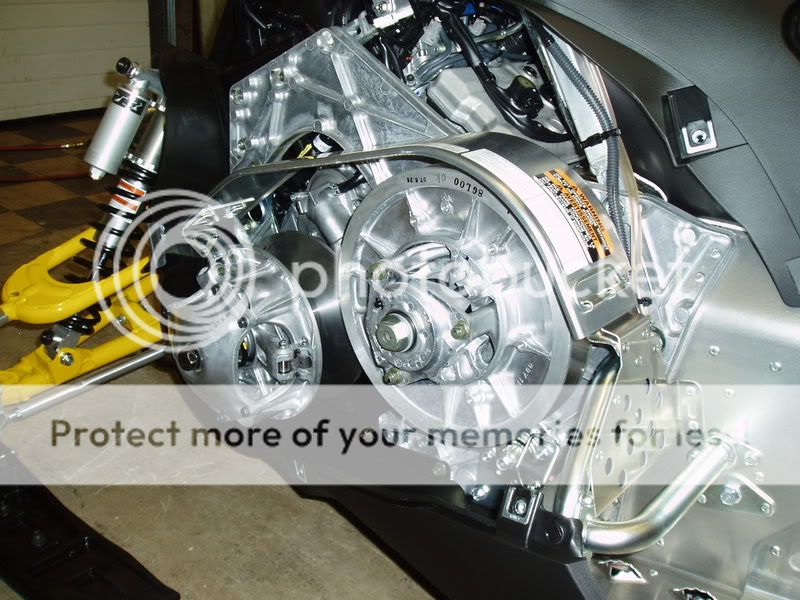

Time to disassemble the chaincase!
First removing the plastic panels!
Little tabs hold the plastic into place. I use a small flat blade screw driver to pop them up and remove them!
Need a 10mm socket to remove these (on bottom/underside portion of panel).
Lower little tab lock under the running board.
Jackshaft, larger & hollow!

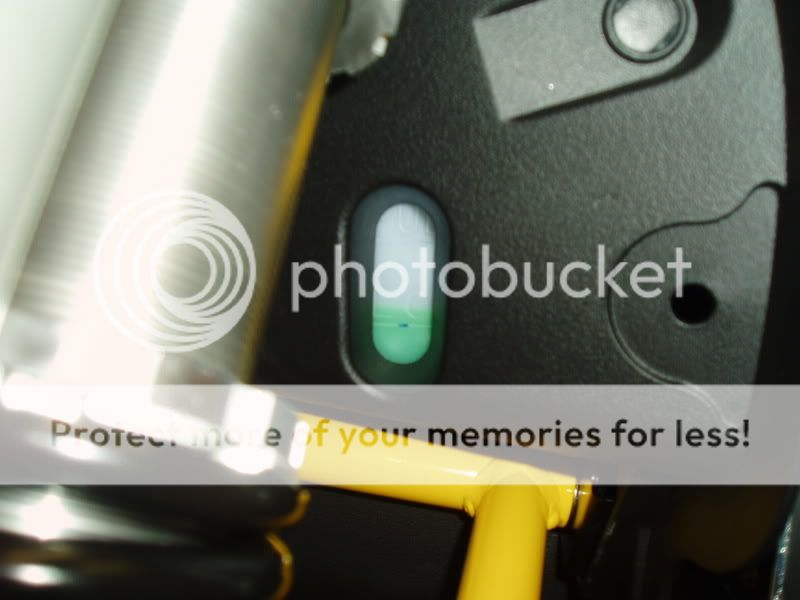

You can check the coolant level in the overflow tank by a little sight area just behind the left shock in front of the clutch.

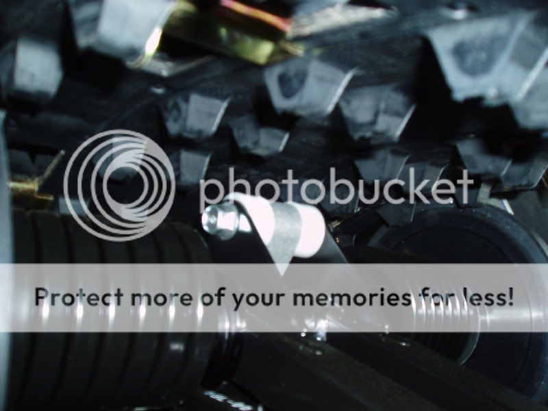

More disassembly pics!
Draining the chaincase oil (use 12mm socket).
Snap Ring & Washer that must be removed for brake disc removal.
Bolts to remove parking brake (use 4mm allen wrench).
Parking Brake removed!
Bolts to remove brake assembly (use 12mm wrench).
Brake assembly removed!
Brake disc removed!
Now we have to remove the spacer behind the brake disc and also a torx set screw to remove the thicker spacer.
Bolt holding reverse idler pulley (10mm socket).
Bolt holding chain tensioner (10mm socket).
Nut to unhook the reverse linkage (10mm socket).
Bolts to remove chaincase cover (12mm socket 5 bolts total).
Also behind the collar we removed on the upper shaft is a small o-ring!
Chaincase cover removed!
Lower bolt holding lower gear on (14mm socket).
Upper shaft showing spacer & washer against top gear.
Showing lower spacer that is behind the gear.
Showing upper spacer & washer that is behind the top gear.
Rear suspension bolts to remove (14mm socket & wrench).
Suspension ready to slide out!
More photos coming soon!

Yes, the clutch cover now has a latch pin instead of the black plastic push lock like the prototype models had!
