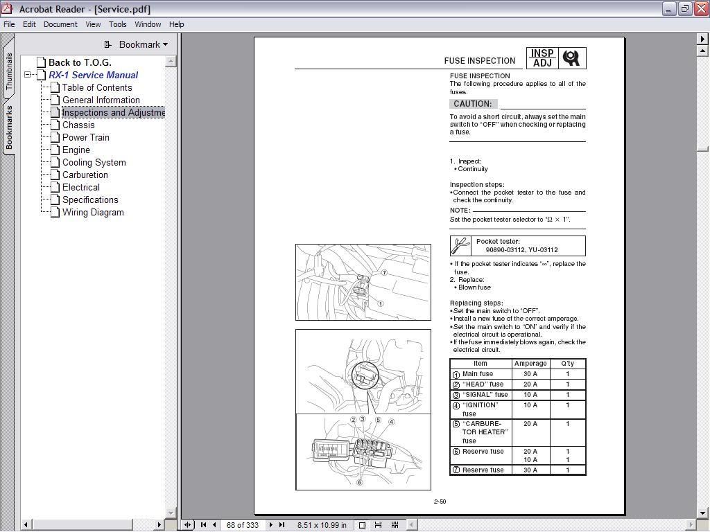

I assume by "code 22" you mean the warning light flashes on twice for about 1 sec each and then is off for 2 sec and then flashes twice again repeating. According to the manual, this means there is a fault in the grip warmer circuit.
Here are a few pages from the service manual on what to check and how. I would start with the main fuse.
Grip Warmer Troubleshooting:
Fuse Inspection:
Click the images for full size versions.
Fuse Inspection:
