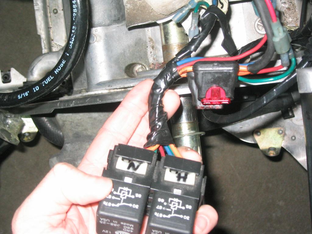

You do have to wire 2 relays one for the nitrous system and one for the bottle heater. This is not difficult and instructions are clear.

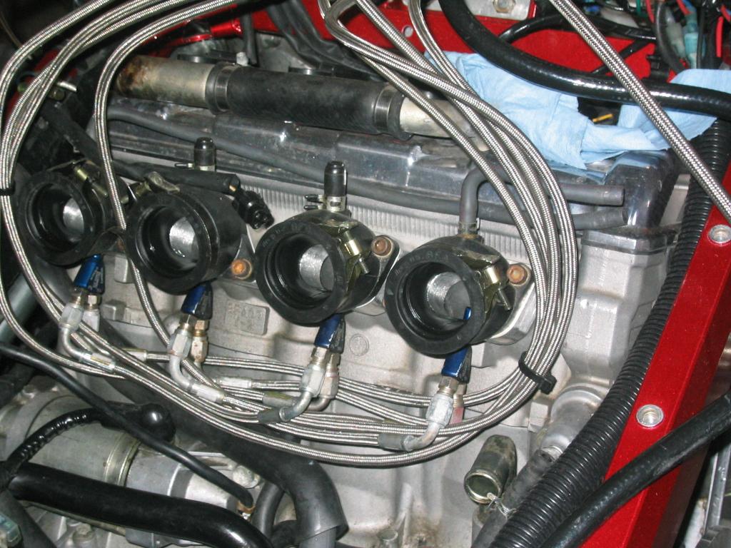

TUNING: This is what I love most about the system there is NONE, no turning knobs listening for detonation, nothing. All jets are marked just install the correct fuel jet and N jet from the tuning chart from NX and your going to get that shot. Thats it!

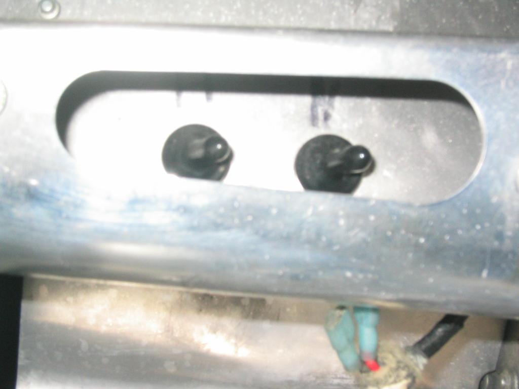

Switches for bottle heater and activation in foot well.JPG56.6 KB · Views: 219 -
