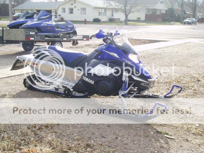

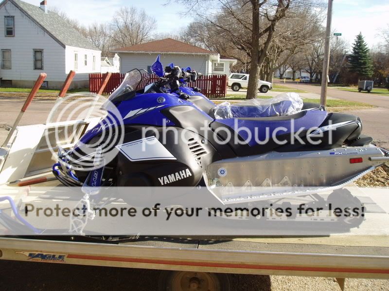

Some beginning pics of making Eric's (Fasttoys) FX Nytro into a 136" model! A few pictures before the build up starts!
That's my ride for the winter! Putting the first Excell exhaust on tomorrow!

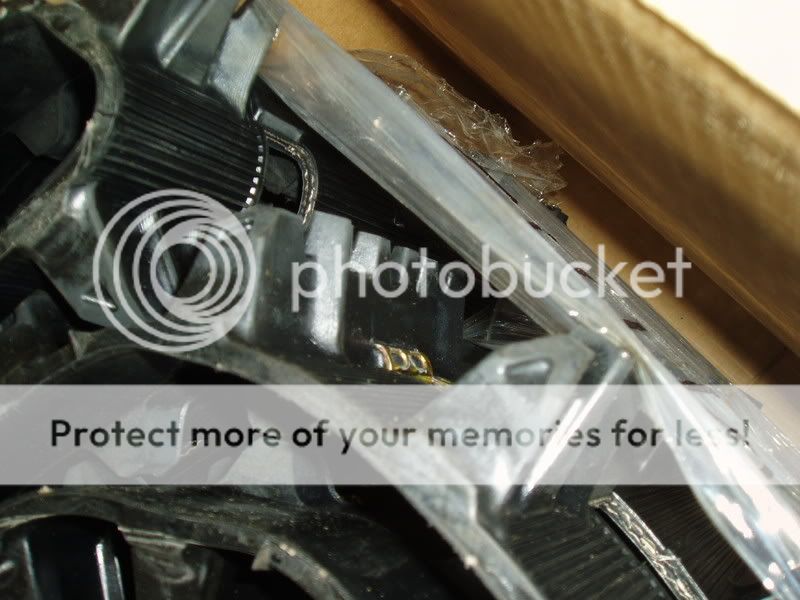

The new track arriving in the box!

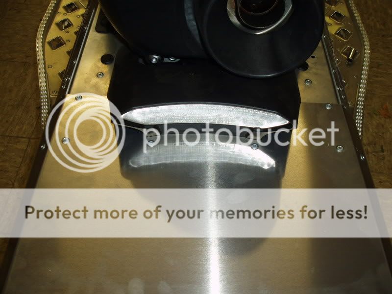

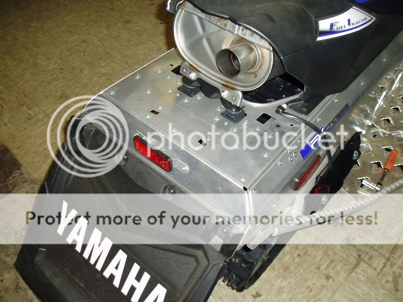

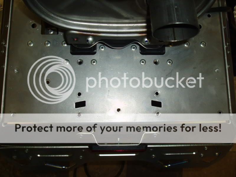

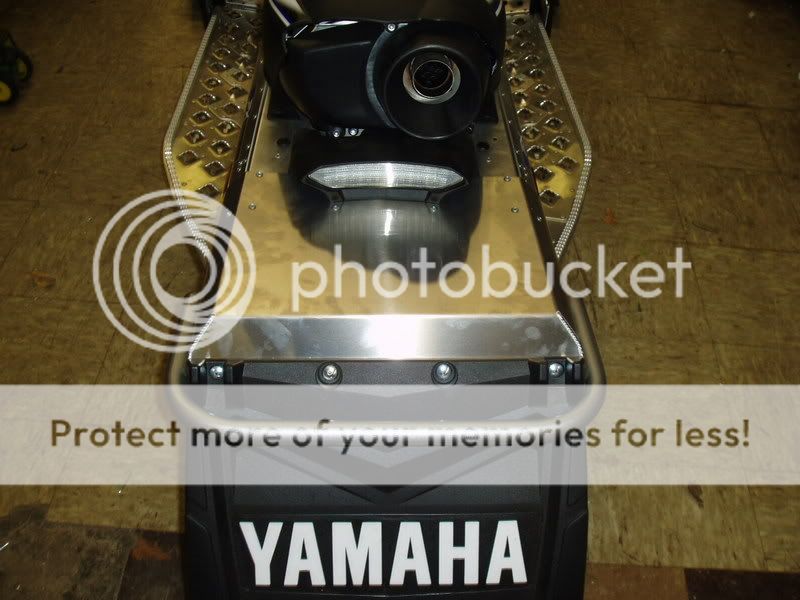

Exhaust plastic and tail light removed!
Drilling out rivets!
Nice & shiney!

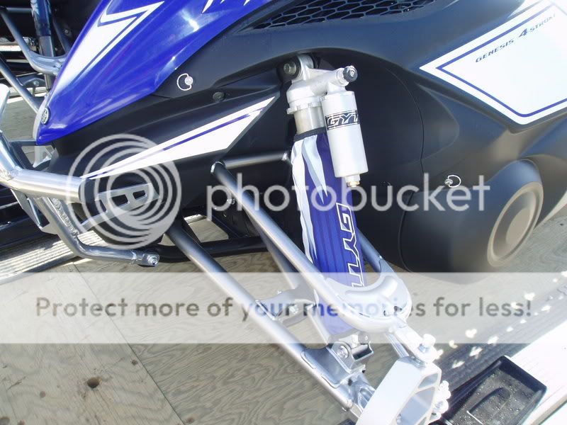

Suspension coming out!

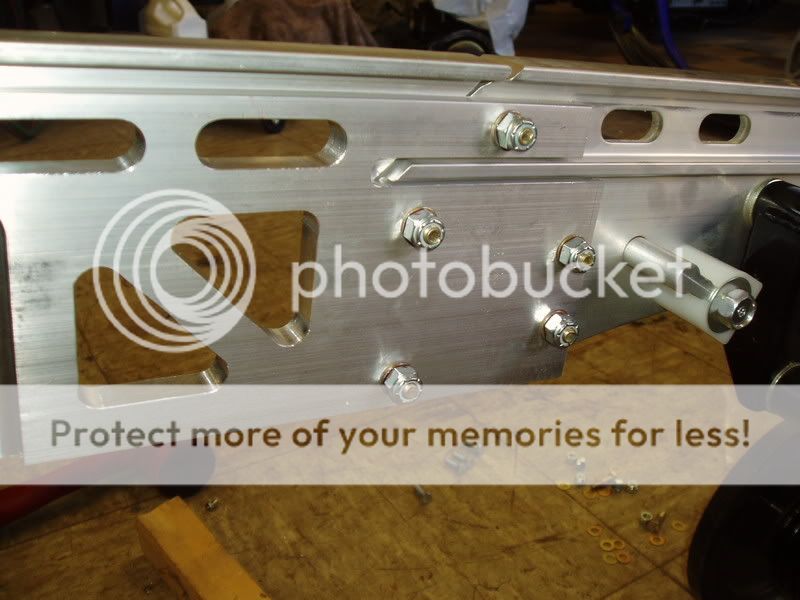

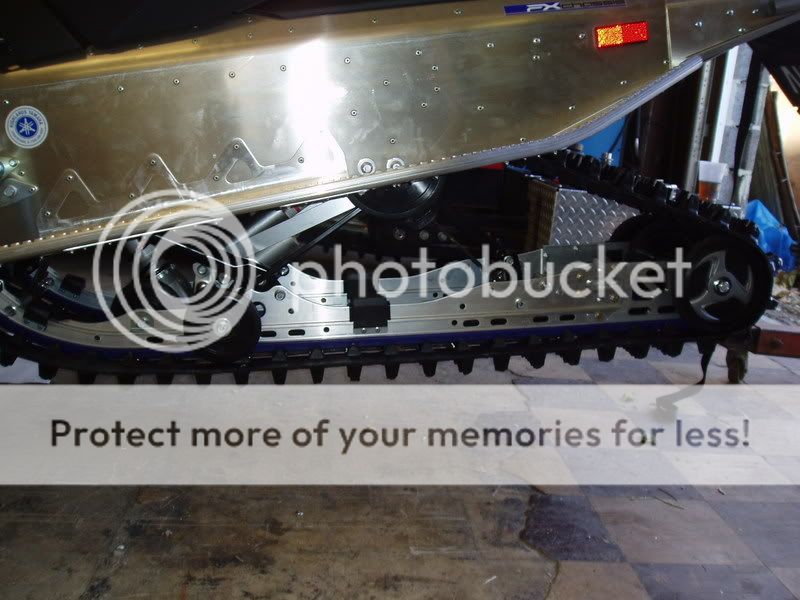

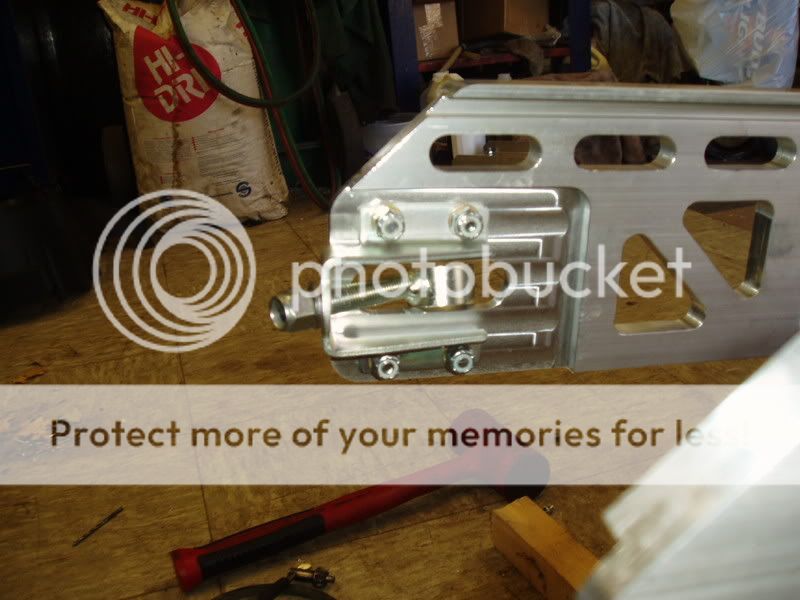

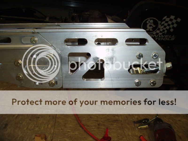

Putting on the rail extensions!

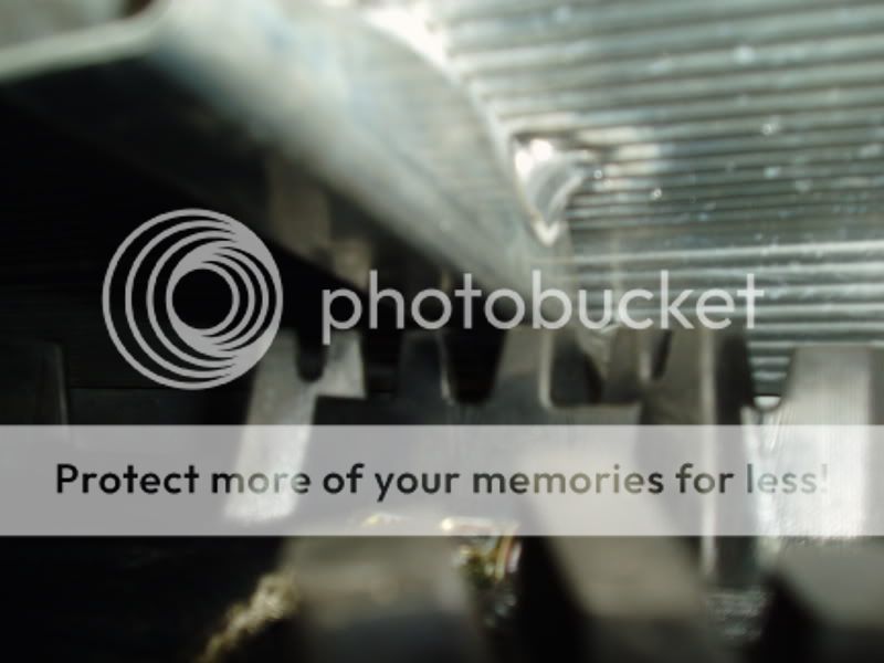

1.5" is all the more track you'll get in without taking out the exchanger guard.

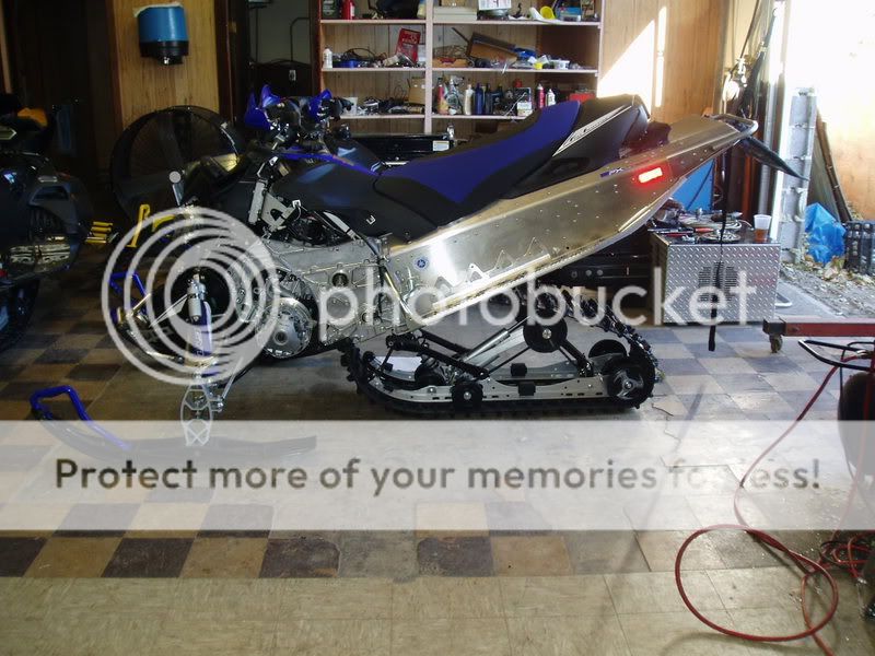

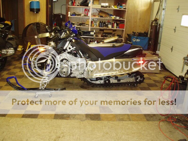

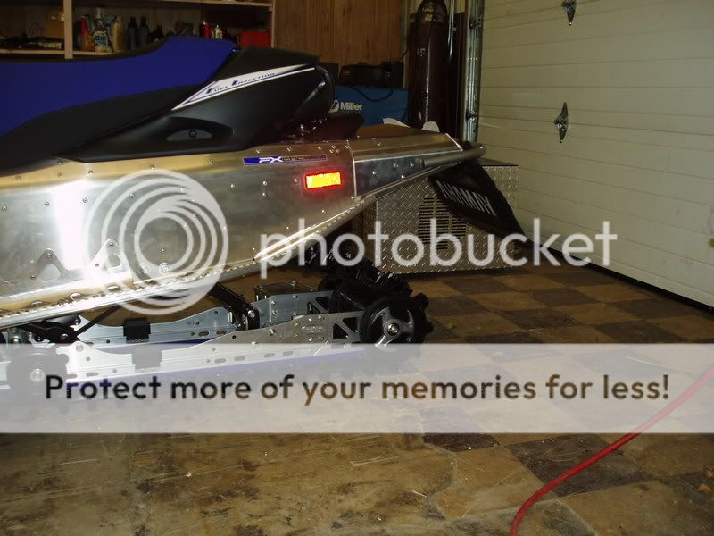

Suspension finished and in!

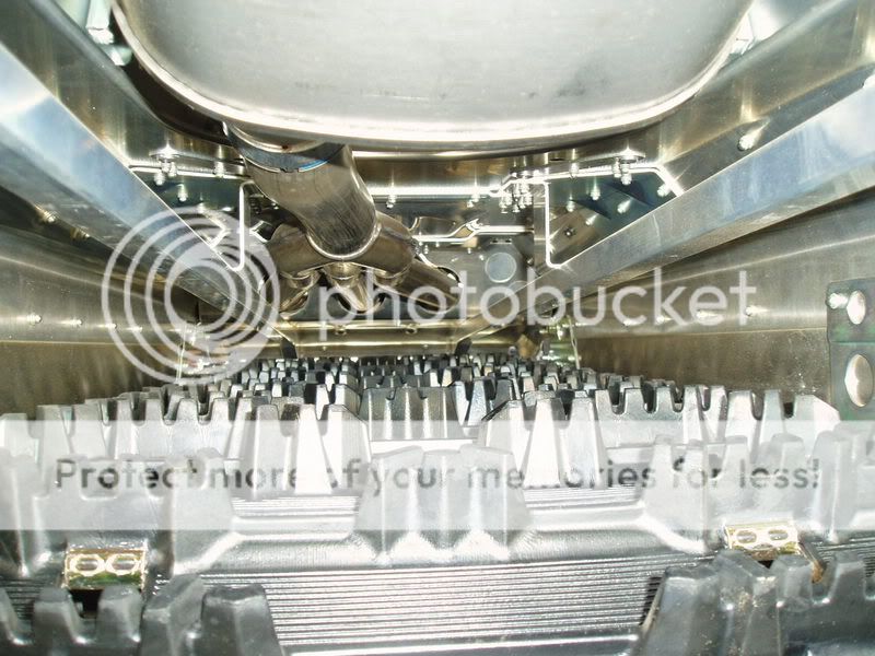

From the inside of the tunnel!

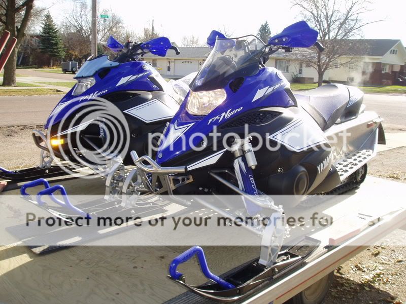

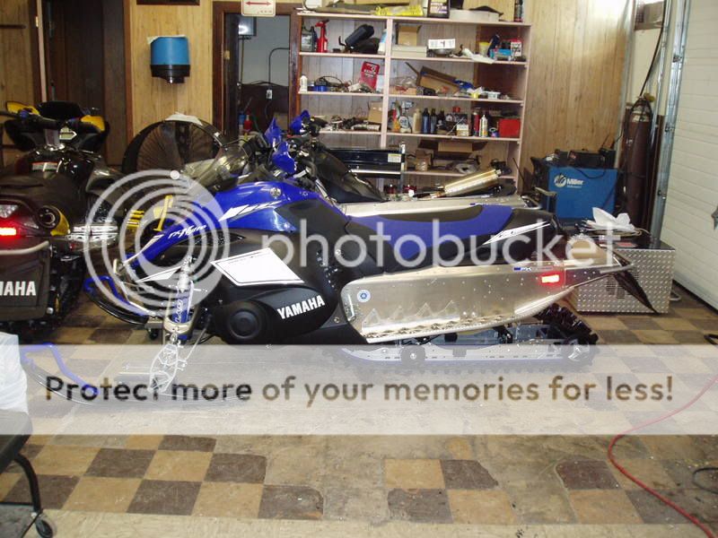

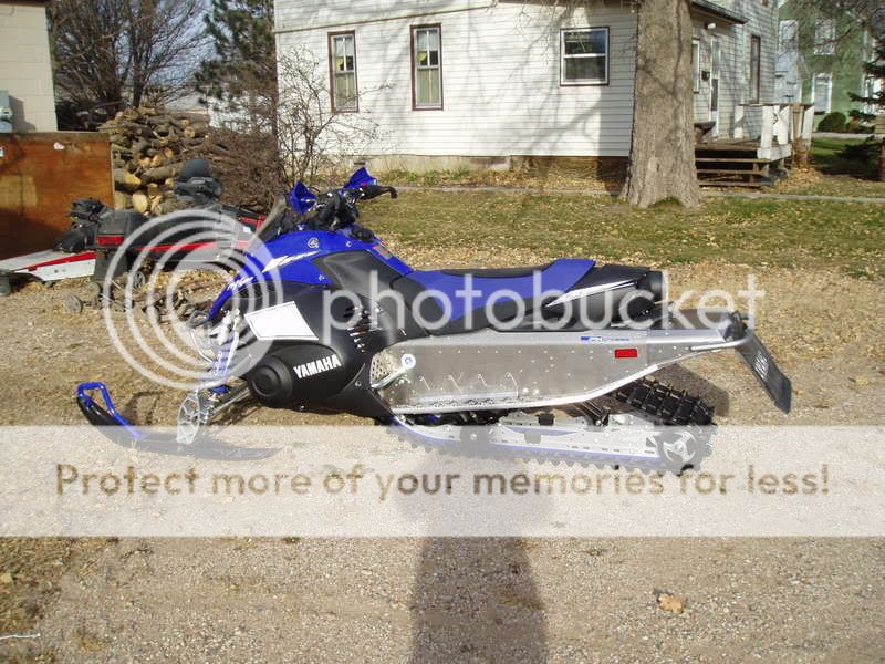

A few overall shots!
that thing looks awwwwwwsome. its gonna rip!!!!!
im gonna have to get some stickers from ya if you have any to put on my sled
Wow I rode the nytro on last years Demo ride and loved it. I could not imagine how much better it would ride longtracked YIKES!!!!! Nice work Allen.

Somebody tell me why yami did not make this sled from the factory..... NYTRO LTX..... 09? lets hope so....
Nitro torque + longer track + deeper lugs = FUUUUUUN!!!!! That sled looks darn good with the extension and long track too.
What track is it by the way?

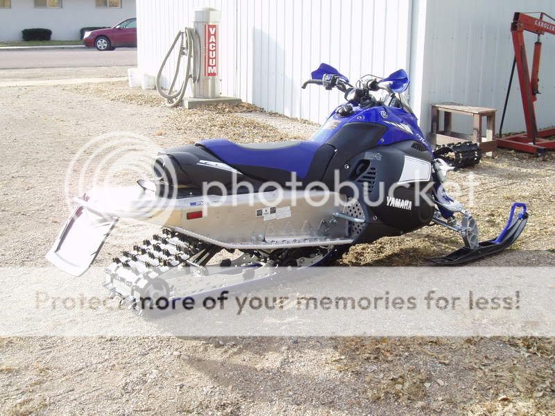

its alive

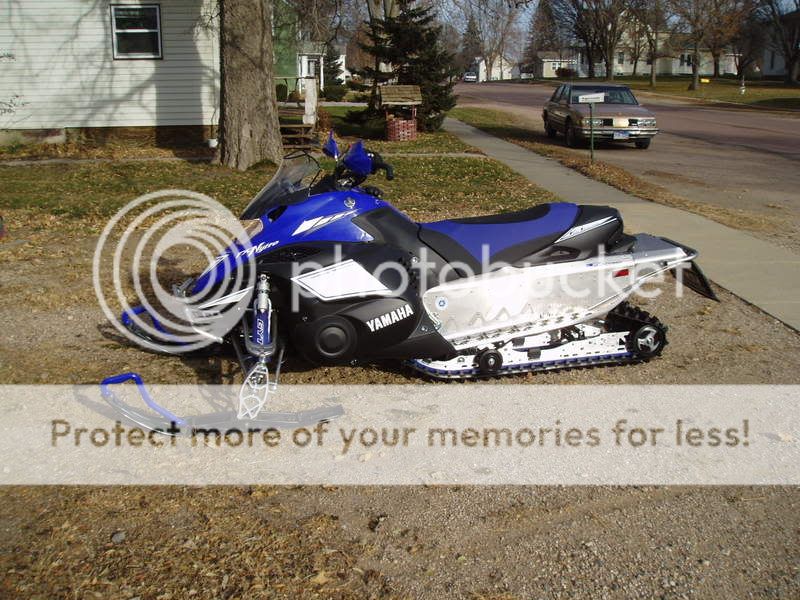

well allen i got it out. Just around my house and yeah it hauls and man does it hook up. im gonna have to tweak on the suspension a little bit. it wheelies way to easy
