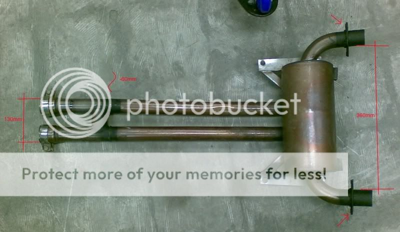

I got wrecked QC-1 03-05 RX pipe and i thought that i will fit it in my 06 Attak. It was not plug and play like i thought first.
Below you can see picture with measurements that i took from original exhoust. I had also cut it shorter 60mm (metric). I had to change pipe "end flanges" as well. i took those from original exhaust.

My bad. I just looked and setting side by side they look alike but back to back the rx-1 pipe is about an inch longer.
I also forgot to mention the flanges for the exhaust tips are different.
