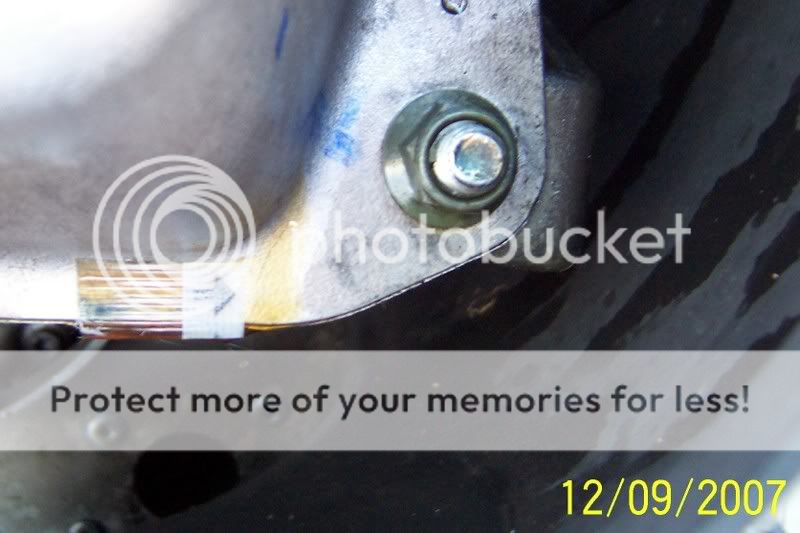

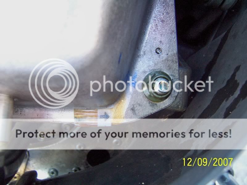

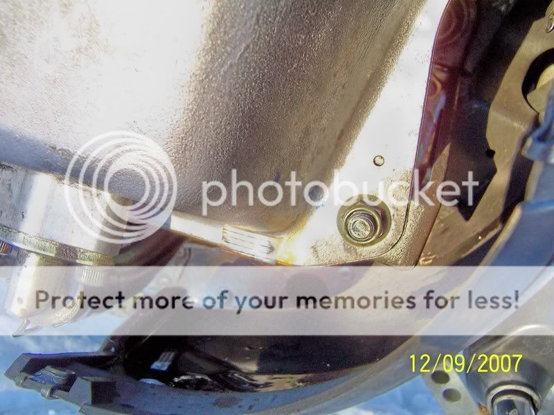

The leak was discovered yesterday. Took the side panel off and trouble shot today. Rode the sled about 2 miles to get the oil warmed up which showed the location of the crack in the tank, and susequent leak.
The crack started leaking between 22,000 and 22,050 miles.
RS Venture Mileage
I was alerted to a problem by a flickering (!) caution indication followed by a steady caution indication and oil symbol on the display panel.
I lost about 1.5 quarts riding. Luckily, I was carrying 2 spare quarts of oil which got me back home.
Overview of RS Venture oil tank crack and oil leak
RS Venture hair line oil tank crack and subsequent oil leak
RS Venture oil tank crack and leak

Thanks for sharing... that'll be a spot to keep an eye on. Any idea where it propagated from? Vibration probably got it....
plowking
Have seen this a few times on other sleds posted here. The tank probably should have a grommet or reinforced piece of metal in that area. I am going to watch my Rage,once it has some miles on it. Don't know if that is going to happen to the replacement tank or if Yamaha has any updates. plowking
hondo
A couple of things come to mind. The die cast aluminum alloy the tank, coupled with the unique vibrations of the three cylinder motor, the tank is bound to crack. I'm not fond of the alloy. I know cutting weight is the issue.
I have followed the other posts regarding cracks in tanks. It seems to be a trend with the three cylinder motors.
Good idea about a rubber grommets and updates.
I'm going to bring that up with my dealer and mechanic tomorrow.
Suggestion to RS owners, carry a spare quart or two of oil. It got me home. Without it the motor could run dry.
