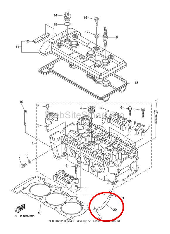

If it is anything like the RX1's, remove your oil filler cap and run a hose back somewhere where it will not get on your clutches. Drill and tap the filler for anything that would fit.
