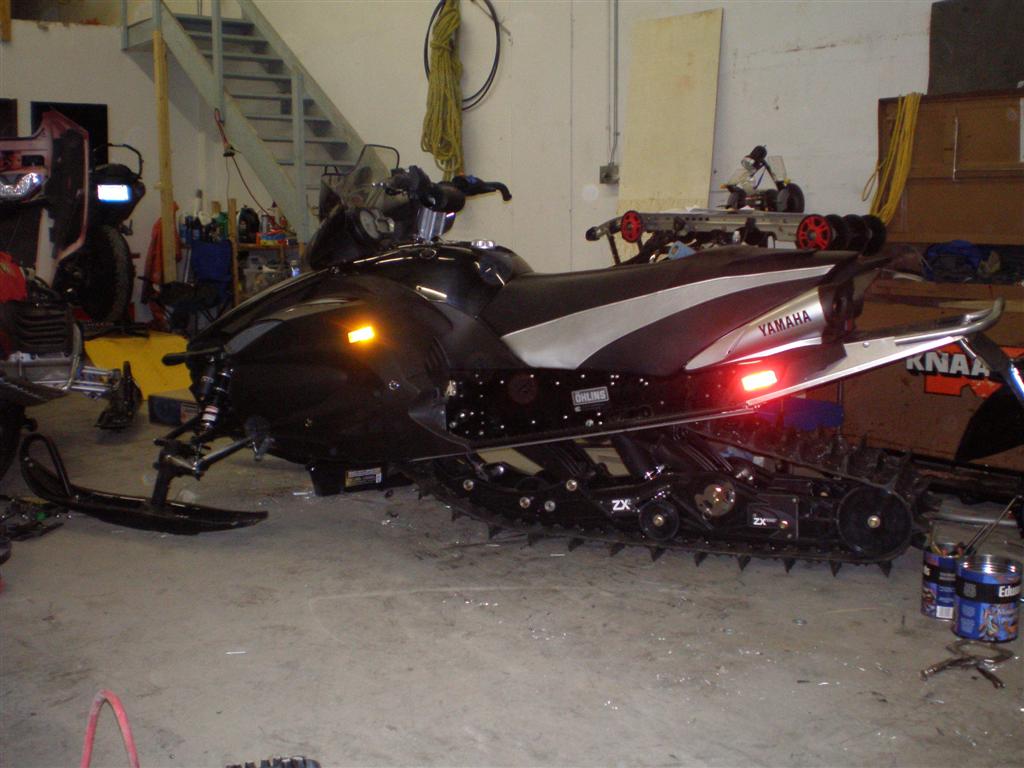

This is the first pictures after the modification is complete.
still haven't had a real good test day. put about 100 miles on the sled so far. I will post better Pictures when i get a chance
Additions include:
Medium Height windshield
Slp Powder Pro Skiis
AD Boivin ZX2 144 skid
9" extroverts
Hartman extension
camoplast 144x 16 x 2 challenger track.
Additions include:
9" extroverts
Hartman extension

I had the same problems with the bearing id also. In my pictures i am missing the front idlers. They shipped me the wrong ones. They very good about it and couried me the correct ones right away. Just call them they called me back quickly. They also said the if you have good snow you can run without them while you wait.
RE: the 16" wide track. yes it will fit. tunnel protectors must be removed and the front heat exchanger protecter must be removed also. There is one but and bolt extending into the tunnel from the gear box. I would put spacers to keep the end of the bolt protruding into the track. and grind down the nut at least an 1/8 of an inch. see photo. I didn't grind mine down because i didn't see the clearance until after i had it all put back together.
It is really close with the 16" wide. i also have a rivit end some where rubbing on the left side of the track hitting a lug 1/2 inch from the tip. I have to find it and remove it or let it wear in.
With the 2" track i find it very close to the mufler clamps in the tunnel i have to rotate them so the bolt end is not pointing down. I will take photos when i get a chance
re: the plates ya they didn't seat all the way for me as well i left them took it for a spin and readjusted the track. Everything ok.

Found out what was rubbingas. There are two bolts from the chaincase that need to be adjusted out if you want to runa 16" wide 2" track. The second bolt is up and to trh front from the bolt shown in the above picture.
