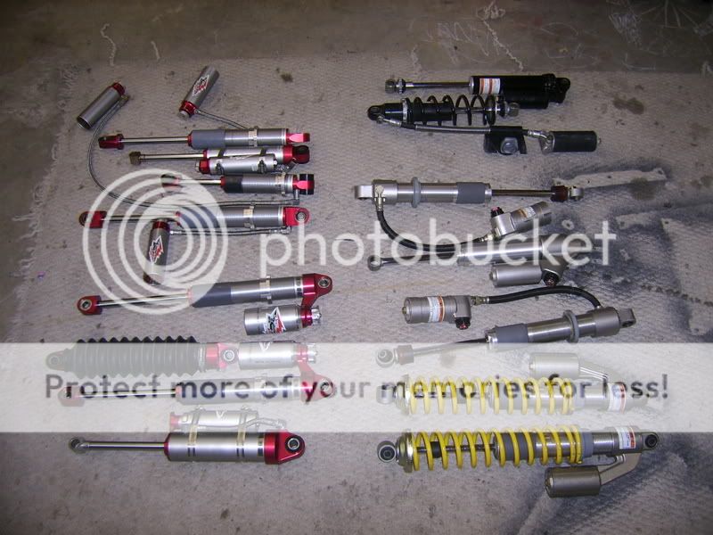

only clear pic I could find of the rear rear shock

ruffryder
08NitroRTX said:It's days like this I forget some details without my cheat sheets!
Any chance you could tell me what the extended and collapsed length of the front track shocks of the rtx and the air shock off of the polaris race sled?
Hoping they might be pretty close.
Nice set of shocks btw.
