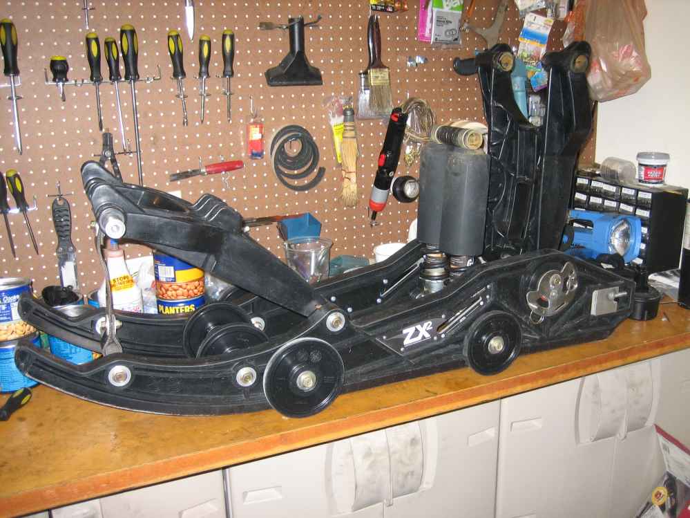

Starting with the install in my 2006 Apex ER. The skid went in fairly easy with the exception of not having a proper tool for the rivets. I even bought a large capacity hand riveter, one of the long handle versions and that managed to brake. My dealer had to finish the remaining rivets for me. I had the holes drilled just needed an air rivet gun to finish. I might remove the ones done with the hand tool this summer as they are not the greatest looking...

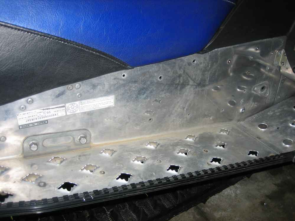

My tunnel needs to be polished back up to remove the old skid marks. I also still have the black mounting bracket on the tunnel where the monoshock mounted in the rear. I am not sure if I will remove it or not. I do like the extra reinforcement.

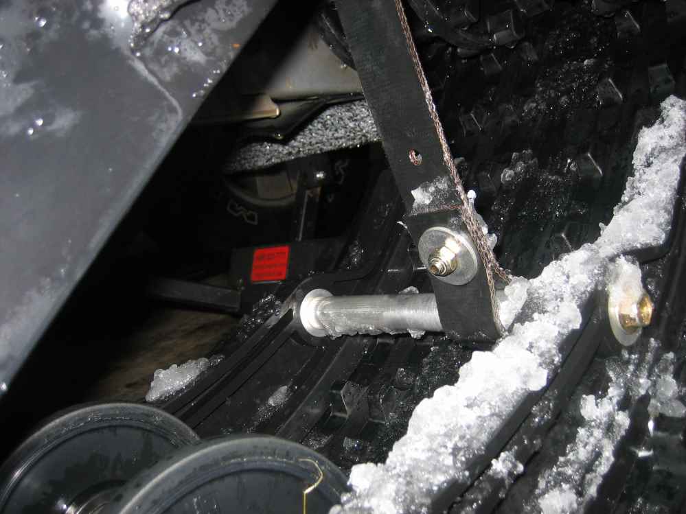

Look at your limiter strap. Mine moved all the ray to the right. Why are there no stoppers? My rubber bushings are shot on both revolvers. Rear axle bolt backed out. Bolt was loosened twice and tightened back up without reapplying loctite. I will reloctite every time now.

Skid has about 700 miles on it now. Setup is still the same with the exception of the shocks. I moved those to preload 3. The skid is still pretty firm. I am going to try to put the coupling on 4 and tighten the springs when I get some time. I need to get the weight to ride more on the rear.
I replaced the rubber bumpers with durable gas line type hose. I only needed to remove the two rear arm bolts on the revolver in order to access these. I read in other posts where the small allen bolt and nut were removed. I did not find this necessary.

My limiter strap keeps moving to the right! I may resort to putting clamps on each side of the strap. Anyone else have this issue?
I spoke to Dennis Boivin this am. He said when in stalling pins at positions 1 & 4 to moisten or WD-40 the bottom of the rubber stops and hold them up with a small screw driver from the opposite you are inserting from and it will make insertion much easier.
Yes my limiter strap has moved to the right as well.

Message from Jeff this AM regarding the strap:
"The washer is punched, so one side/corner should be rounded and not go true the strap. You don't have to over torque the bolt, just enough to prevent the movement.
Tight it up at the bottom so it does not move on the shaft and keep the top with a little movement."
Yeah, my limiter strap shifts too, but to the left.
