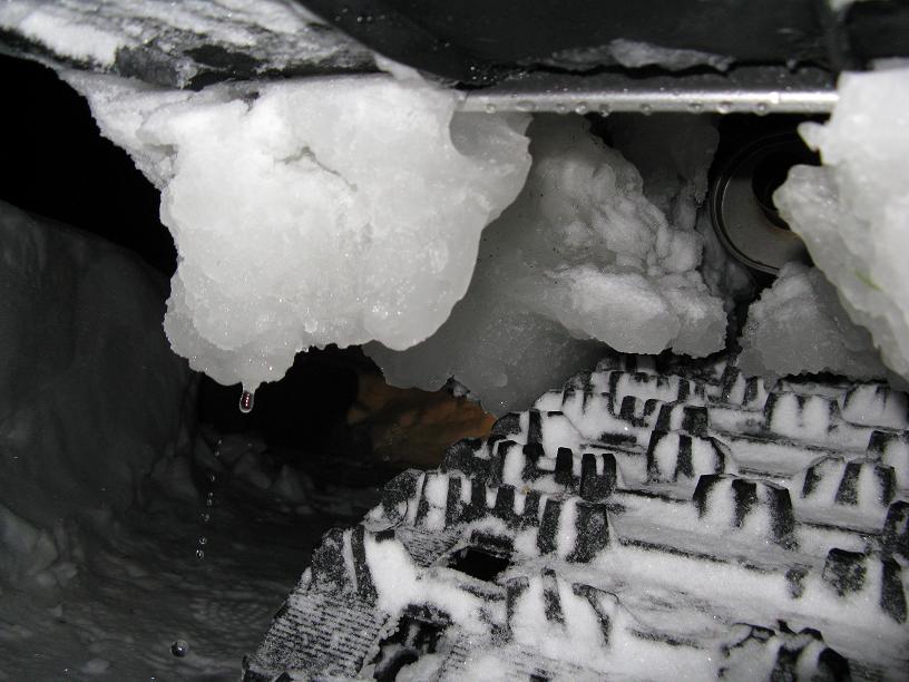

Thought this should have it's own thread, post pics of Venture Lite and Multi
Purpose Tunnel Ice Buildup. Here's mine after a 125 km (78.125 mile ) ride,
taken after we lifted and slammed the rear of the sled down 3 times.

Hey Snoblowr, I have an MP and it has built up ice like that but not quite as bad. I carry a medium sized rubber mallot now. Whenever I stop for anything I knock the tunnel clear by hitting the bumper or tunnel sides. I will be re-routing the tail pipe so the exhaust exits outside of the tunnel, I think this will help.

Re routing the pipe sounds like a good plan Karl. But we shouldn't hafta correct design flaws.
I am willing to bet that the extra weight of these ice boogers will eventually prematurely wear out rear shocks, springs, suspension , idler wheels, tracks, hyfax and ( speaking for myself ) my bloody back!

My MP also builds up with ice. It is definitely a design flaw to have that exhaust in the tunnel. I keep mentioning it to my dealer everytime I'm in there but haven't got any answers yet. I carry a rubber mallet with me as well. Karl, if you get that exhaust rerouted make sure you post the results. Topper

I have always dealt with a little ice build up, but last weeks cold spurt certainly showed me what some of you have been saying ... I must have removed 80 pounds of ice from the tunnel Saturday after a cold Friday night ride of 60 miles.

What if you go somewhere overnight and cannot put your sled inside? You'll be frozen to the ground the next day and your buddies will be gone riding on their Bombs, ACs and Poos.. how embarrassing for a Yamaha owner! I'll re post my pics later - don't have time tonight. Like I said on the previous thread, Yamaha is requesting input on improvements they supposedly made to the 2008 - so please give it to them :exc: . Good idea to get this going.....And I agree this is not a problem that owners should have to fix - no way.

Topper, I won't get to the exhaust re-route until some time in March, but when I get to it I will post on what I did. I also agree that we shouldn't have to redesign these sleds. I have often asked myself if there was any field testing on these sleds before production. Having been away from sleds for over 25 years I am not quite sure how the manufacturers behave when presented with widely experienced issues...read design flaws. my assumption was that once I bought the sled and the warranty was up...the issues are mine.

SNOBLOWR said:I am willing to bet that the extra weight of these ice boogers will eventually prematurely wear out rear shocks, springs, suspension , idler wheels, tracks, hyfax and ( speaking for myself ) my bloody back!![]()
You bet! Not to speak of the track! Lots of wear on everything!
The suspension wheels that get totally enclosed in ice and can't turn...
The snow that is STILL getting in to the engine compartment and locking up the steering. It's a little better now, but I still empty the rubber boots daily!
The dents on my muffler from ice breaking loose and jamming through...
We end up with the same weight as the 120hp Venture, without the extra ponies... but we do get better ergonomics... in my opinion...
karl said:I carry a medium sized rubber mallot now. Whenever I stop for anything I knock the tunnel clear by hitting the bumper or tunnel sides.
Topper said:I carry a rubber mallet with me as well.
How are you guys getting rid of the ice that forms fwd of the muffler???
I get these long, thick pieces that drop from the corners of the tunnel that can't fit through. The only ways I see to loose them are:
Thaw it
Drop the skid frame
Take the muffler off
Let it grind between the heat exchanger and the... track!!! This can't be good for either of the parts!!! But... it is what I end up doing... I do kick it often, so I am dealing with smaller pieces, but I often ride a full tank without stopping... so... I grind a lot of ice...

I haven't been worrying about the ice in the front of the tunnel but it has caused some premature track wear I'm sure. I don't have near the miles on mine as you do so my original track is still in fairly good condition. I wonder if the extra inch of width doesn't clean a bit more of that forward ice out as well. Anyway I sure hope Yamaha comes up with some kind of a fix for the ice problems. TopperHow are you guys getting rid of the ice that forms fwd of the muffler???

Pictures of snow/slush ice build-up after 68 and 174 Km on Saturday. My sled is currently sitting outside after a mild spell on Tues (29th) I attempted to clean out the ice for 30mins and couldn't get the stuff alongside and ahead of the muffler. So it is supposed to be mild for the next two days and I'm hoping it will thaw out, otherwise I will be unable to use it without risking damage to the track, suspension, etc.
Do you hear that Yamaha a $10,000 machine that I cannot use due to a design flaw!!!
I hope potential customers see this and are turned off from buying until this is fixed because they are selling like hotcakes here!! Obviously Yamaha did not do their
on this machine.
As for the idea of routing the tail pipe out the back, this may help somewhat but I think it will not be a total fix because you will still have the heat from the muffler. I hear that guys with machines with mufflers underneath the seats also experience build-up problems.
