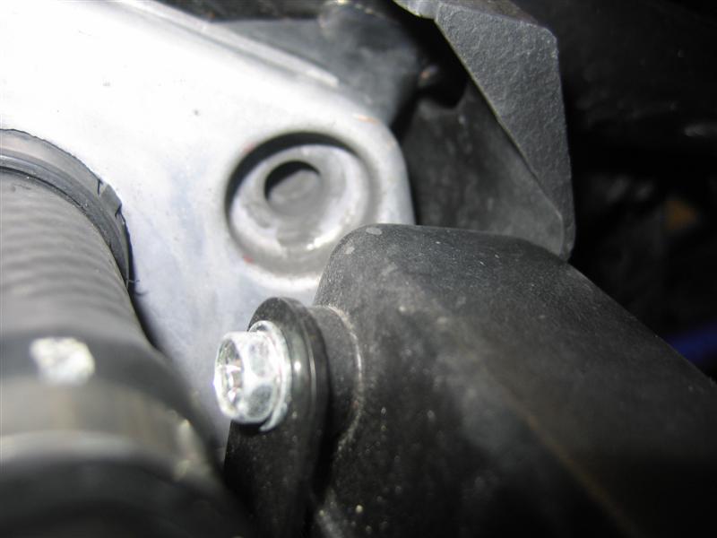

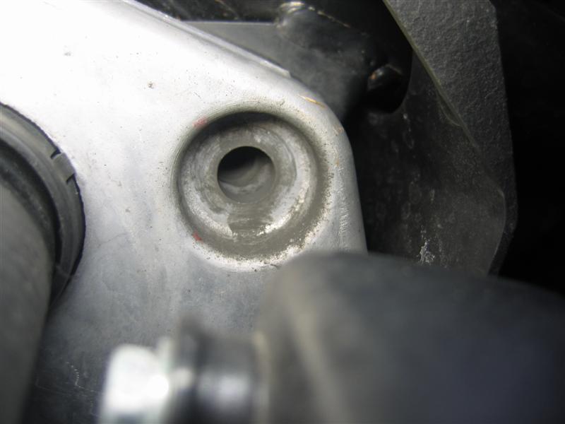

Sled pretty much thawed out overnight.Going over everything simple before riding this morning.Rear suspension 08 updated A+everything straight tight and no cracks.New slides still in great shape.A-arms with new bushings and grease zerks A+.Nice and tight everything straight.Spindles A+ bumpstop marks are bigger but no cracks.
Now the bad news.Took the boots off yesterday to check if I was getting alot of ice in there.It wasnt bad since recall.I give that a C since there was some.
Get out there this morning and find the bolt laying in there.It was under Ice yesterday so I didnt see it.My heart sunk since I had to figure out where it came from.Took pic to post to see if you all could help.Then I spotted it.Front frame mounting bolt!I have never touched this bolt.There is no Loctite on it.Hole is not lined up anymore also so either the frame is tweaked a little or all the rest are loose also.Sorry to say but my Phazer failed my little test.This means to me that it is MANDATORY that everyone remove,Loctite and torque to spec every single nut and bolt possible.Dont skip any since as evidenced from red paint mark this was supposedly torqued at factory.I need to go ride now to cool off.-15 deg should do it.

I hope not.Turning adjuster around might work.It was made a sticky because of the bolt falling out.That bolt in addition to the left and right engine mount bolts that were previously loose makes a real concern that hopefully everyone takes care of.
Was going to start going over bolts but this is my last day off.So I hopped on SRX and went to dealership with bolt in pocket.After discussion will bring sled there tomorrow untouched to document the issue.I am requesting a new front frame member since it is now obviously tweaked from bolt falling out.I was warned not to get my hopes up since YES coverage will deny claims for loose bolts since they are part of maintainence.I would agree but this is not on a moving part and removal of radiator would be necessary for proper torquing.Am I required to torque every bolt on machine?We will see and I am confident my dealer will help the cause.

Yamaha is covering it.New front frame assembly and labor.Y.E.S. will not cover this type thing.Part is on its way.
