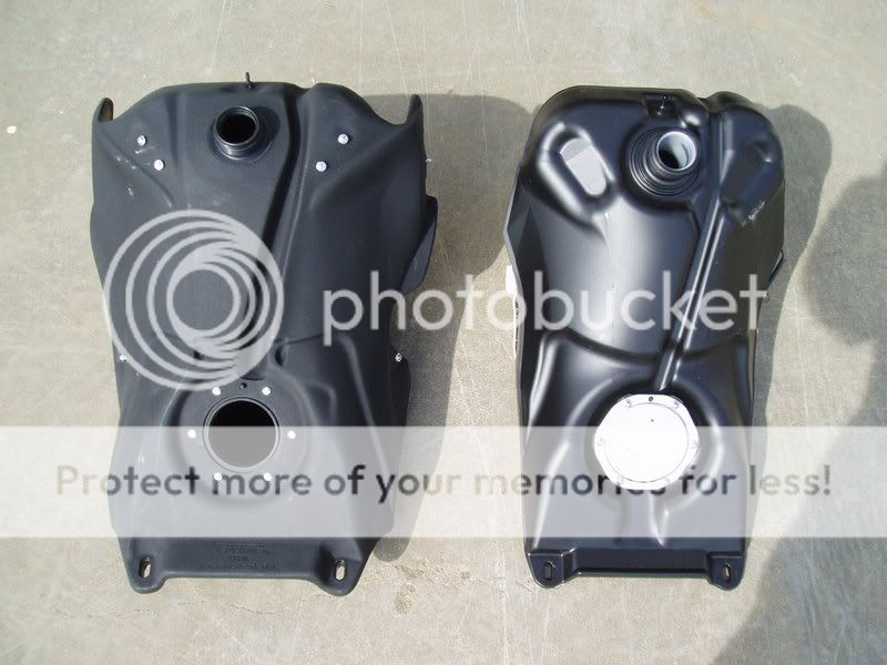

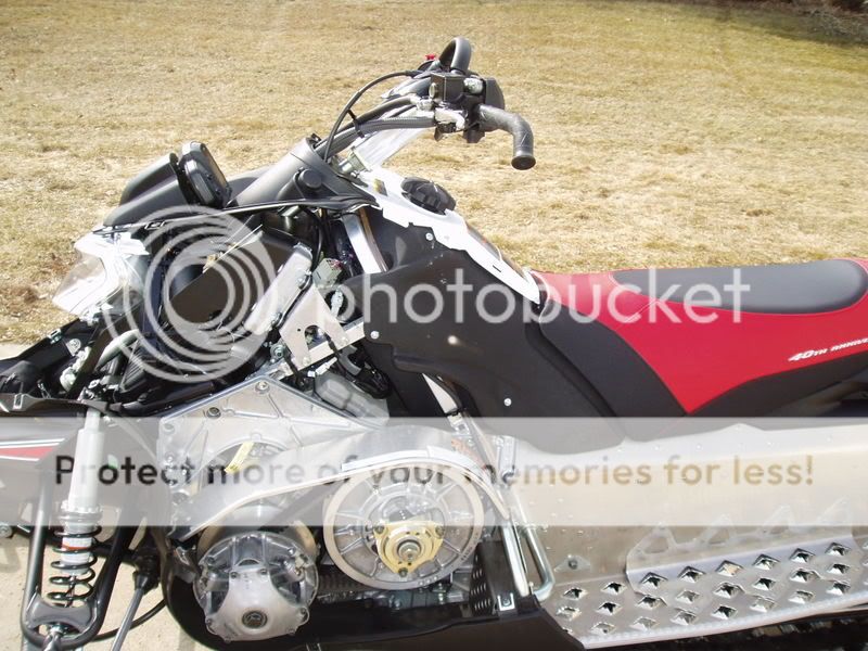

Got a tank from Seth last week on Thursday. Here is some pictures of it side by side with the stock tank and then installed. I would say the swap for an average mechanically inclined person would be 2-3 hours. I would also recommend getting a new rubber gasket to seal the fuel pump assembly as the original one likes to expand. If you don't have a new gasket wipe the old one off with a paper towel and throw it in the freezer for a few hours and it will come back down to size.
skyboz
What about swapping the heat shield from the stock tank to the trailtank??
That looks factory!!! looks like a great product....
Does this require that you eliminate the Dzus fasteners on the shrouds after the new tank is installed ? Do they give you any Duct tape to cover up the edges of the white plastic tank cover? Sorry, a little sarcastic there. What is the advertised capacity of the new tank?

skyboz said:What about swapping the heat shield from the stock tank to the trailtank??![]()
Skyboz, I don't think you'll be able to take the heat shield from the OEM tank simply because I think it'll tear possibly (this is just my opinion, I did not try to take the heat shield off the OEM tank).
benny said:Does this require that you eliminate the Dzus fasteners on the shrouds after the new tank is installed ? Do they give you any Duct tape to cover up the edges of the white plastic tank cover? Sorry, a little sarcastic there. What is the advertised capacity of the new tank?
Yes you eliminate the dsuz fasteners on the top shroud and the rear side panel mounting position for a phillips head screw with shouldered washer. The advertised capacity is 10.4 gallons.

Is it that plastic with a dull finish that scratches real easy?
Look that way in pics.

I just ordered one. I'm not happy about this. that sucks you have to bust out a screw driver to open the hood. There has to be a alternative. ?
Yes you eliminate the dsuz fasteners on the top shroud and the rear side panel mounting position for a phillips head screw with shouldered washer. The advertised capacity is 10.4 gallons.[/quote]
I was thinking the same thing. I guess if you want the fuel range you have to give up conveniance, fit and finish, ect. I would be a little spooked to not have a heat sheild under the front of the tank also. A little foil tape goes a long way. Not trying to bash anyones purchase, just seems like not alot of thought into the details. What do you expect for $10k? LOL

Thank you very much for the pics SRXSPEC. I have been waiting for someone to have purchased the trail tank and mounted to the sled. It looks terrific for aftermarket. If some have a hissy fit over the Philips screws, then obviously these are riders not wanting to go further than 90 - 100 miles on a tank of fuel. Personally, I would like to have some distance rather than worry about coming out of the hills before the RX-1's for fuel. An additional 25 miles and having to carry a Gerber multi-tool for the Philips screws is fine with me. Doesn't everyone carry a multi-tool on them for emergencies???????
