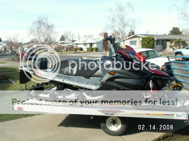

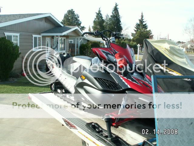

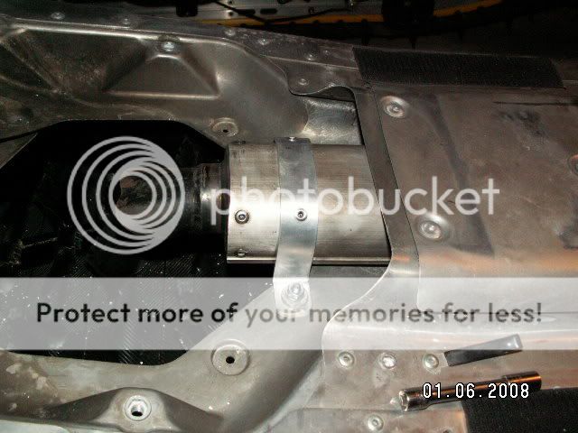

i think this is the one i bought from you pro. i installed this on my sc apex mtn . it removed a bunch of weight and made the sled much crisper. had to add weight to the primary ,bouncing the rev limiter. thought i had problems in deep pow but the problem was not enough intake air. installed a snorkel and problem solved. not too loud in deep pow but a little loud on the trail,sounds sweet!!heres some picspro116 said:I made one for my apex mtn.I don't have pics but I bought the muffler from hauck with out the 2 little muffler and tail pipes.The outlet on the muffler i cut on a 45 so it blew the exhaust on a 45 degree angle out the bottom.It sounded awesome but was a little on the loud side.

yep i made a block of plate. used muffler hold down bolts to bolt it down. pretty simple.
obile yep that's the one you bought from me.
