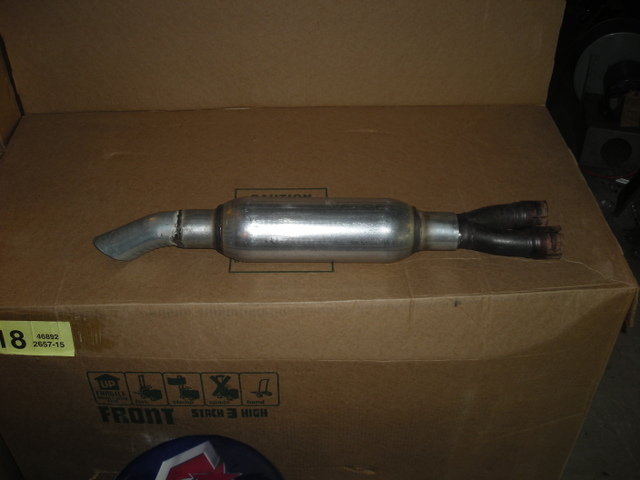

Here is mine,
I used a 4" Summit Racing Glasspack and a 2.25" down turn.
I welded the glasspack to the stock Y from my stock exhaust. There were some other modifications involved.
Here are some pics
I still need to attach the rear muff support. It will be covered with the new pc of alum that will cover the whole the muffler sat in.
The hardest part for me is going to be making the rear seat support. I am goint to leave the rear of the sled open so I want to make it look nice. Mabey some powder coating will be in order.
This is a little on the loud side. Once it gets into the pow it will be quieter.
Here are some pics

Hey Frog!
Looks good!
Post a pic of your rear muffler mount! Like to see it.
You may still want a baffle yet, mine droned without it and got very tiring while riding.
