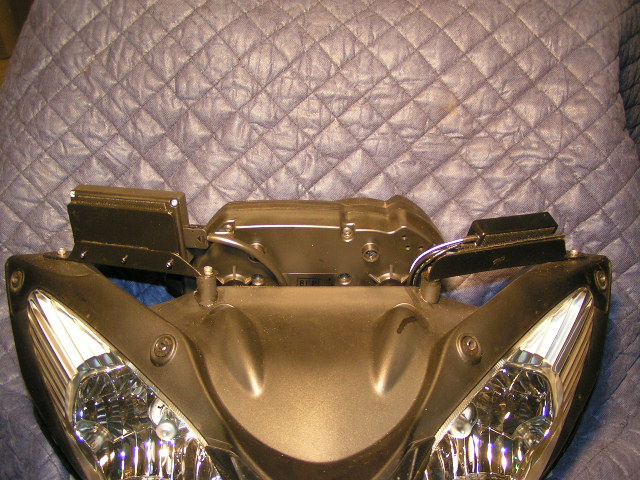

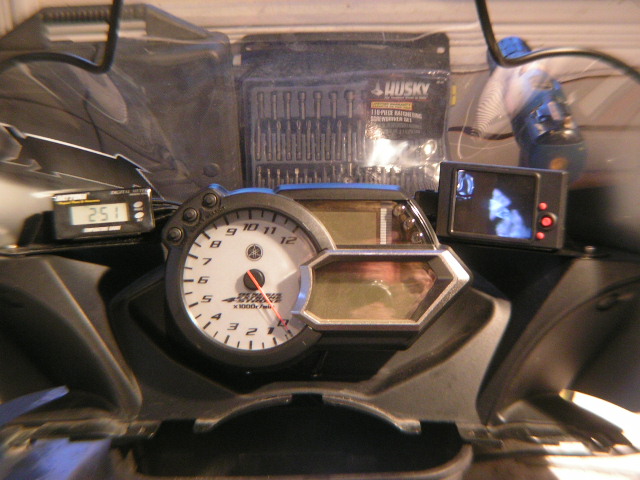

Here are some pix of the Temp Guage and also the Power Commander LCD I have just installed. Having once lost an expensive instrument package(turbo) after rolling the sled - the screen was crushed down onto the pod- I wanted to give this installation a little protection, Used aluminium angle mounted on rubber bushes either side of the tacho and instruments are made removeable by using industrial velcro to attach. Also they are in the natural view area and I can get to the buttons on the LCD easily with gloves on.RacerDave said:Post up pics of your temp gauge installs!!
Hope this is helpful

Great location and nice job on the bracket fabrication. Just curious as to why you didn't install the rivets from the top side for a cleaner look?
markddapexgt
Ulmer Temp Guage install
Sorry The pix dont show very clearly. The brackets are mounted with St.Steel Allan screws through rubber mounts to absorb some of the vibration. They look neat and do the trick. I will get some better pix if you like when I get home to my "Real Job"!!!
Blue Dave said:Great location and nice job on the bracket fabrication. Just curious as to why you didn't install the rivets from the top side for a cleaner look?

I see now that it is the allen head that I thought was the back side of an installed rivet. Nice job!
markddapexgt
Ulmer Temp Guage Install
Thanks - I just have a digital battery charge indicator to add and thats it for the instruments. Still lots to do before the snow though as we did high mileage last year and the rest of the sled is completely stripped! I am sure you are familiar with all of the problems!

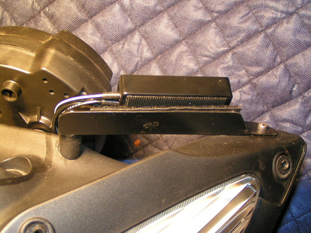

MarkD
I can't tell from your pics. What are you brackets fastened to on the ends toward the center of the sled? Did you fasten to the back side of the speedo/tach unit? I'm trying to get ideas to mount my temp gage too. So far I am leaning toward a piece of angle aluminum fastened on top of the hydraulic brake reservoir.

I removed the windshield so that you can see better pix from the opposite side. There is a thin rubber mount on the outer mounting points and a rubber spacer that makes up the height difference on the inner points. Hope this is helpful
Shootinstick said:MarkD
Shootinstick
Thanks for the better pics Mark. I will have to look at that mounting option. I fear that my other choice on top of the brake could cause problems with getting a gauntlet on in really cold weather.
