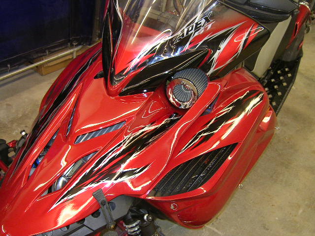

We just got blasted with snow went out to shop messing with my apex to go for a road rip noticed that I had a little sneeze when you jabbed the throttle anyway to make a short story some how I have my cluster all messed up when I went into the CO settings seems I got into di instead went through and made a mess sled doesnt run good at all now can someone give me all the settings for the factory di and related to get it back to stock settings Thanks

you did not messed -up the settings in diag you probably fire up the injector and fould a sparkplug in diag you should unplug fuel pump to prevent this ihave seen fire -up injector first then the coil and make a big explosion in engine

Your sneezing is from stale fuel. My 06 Apex does that the first rip of the season around the house until I run it and get fresh fuel in her...

Speedmax you are somewhat correct on my problem. I fouled it running through the di part of the cluster several times and then I pulled off a bonehead by trying to start the engine with my rb3 unhooked. You have to unhook iot to do the paper clip groung to get into the cluster settings then I tryed firing it up wich it did run but like crap, I assumed I had changed some values in DI but in reality it was fouled killed a plug and also stock fuel with large injectors so infact I was running way to much fuel in , Its fixed now and has been out on the first snow, Oh boy does it ever pull, the 2871 turbo pulls like a train with the rb3 new header and duel hindles and the ole one eye air filter, everything seems to be a perfect match, cant wait for ice to come on the lake now.
