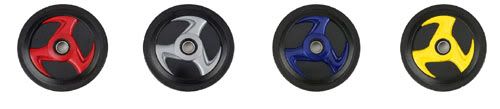

apltx08
I've had very good success with these...

The spoked rear axle wheels use a replaceable 6004 bearing. The spoked idler wheels use a replaceable 6005 bearing.
apltx08
Blue Dave said:The spoked rear axle wheels use a replaceable 6004 bearing. The spoked idler wheels use a replaceable 6005 bearing.
Exactly..."6005" bearing are very hard to find and 3 times the price of "6205" and do not last as long either as a good old "6205"...these IDLERS use "6205" if you go with these you MUST machine the rear inner mounts to centre IDLER between cogs due to the larger BEARING but well worth it.
You will notice in the pic small CRACKS on gray spokes its only on the INSERT not effecting durabuility, this IDLER has 12.000kms I keep it as a spare

Well I spoke too soon. (no pun intended) I posted thinking that I would have my spoked wheels installed by now but the black spoked idler wheels are backordered from Yamaha.
So I had my dealer change my order to the ones shown above that Apltx08 is using. These wheels use the 6205 bearing which will require slight machining of the inner wheel mounts and I believe will require a longer bolt on the outer wheels.
Somewhere somebody had posted the Yamaha p/n for the longer bolt. Can anyone please post the p/n for the longer bolt again?
