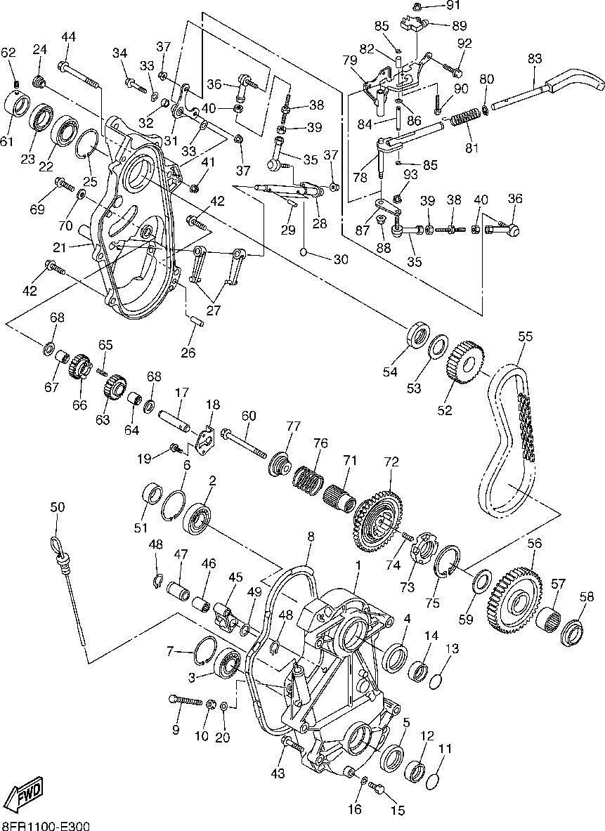

Is there any other bearings that should be replaced, besides these 4. My apex has 9400 miles on it.
What bearing is #23 in this attached fische?
Also I can't find this bearing on the fische.

You are welcome!
The bearing is actually number 22, it is the outer chaincase bearing behind the brake disk.
#23 is the seal.
This is off the top of my head, it is a 6502.
It is an industry standard $5 bearing.
You buy the 6502 2RS (double rubber seal) model and simply remove the inner seal with a screwdriver.
On all the chaincase bearings, poke a small hole in or remove the INNER seals entirely and the chaincase oil will keep them lubricated.
They will last almost forever that way.
Drill a 1/16" hole in the clutch end bearings like shown here:
http://www.ty4stroke.com/viewtopic.php?p=569964#569964
And they will last almost forever.
You will also see the tool I made for removing and installing the upper secondary end bearing.
Also shows the re-grease holes well.
The upper secondary end bearing 93306-20650-00 is in the Frame 2 fische.
(I know, what a weird place to put it...)
Hope this helps!

Vandelay Industries said:Hey Rock. Should the grease that the new bearings come packed with be cleaned out before going into the chaincase? Or is it ok to let it mix with the chaincase lube?
I just wiped the excess out and installed them.
Any Lubricant is just that, lubricant.
As long as there isn't some weird kind of interaction between the lubes, don't see it as an issue.
The factory seals will leak the oil to a point anyway.
One of mine was filled with oil from the chaincase when I disassembled it with a slight grease residue.
Would get the Clutch end bearings from your dealer, and the Chaincase end bearings from local suppliers or the net.
That will save a good bit of money.

Just replacing my bearings now and came accross this great bit of research from Rockmeister- thanks! While checking the catalogue I found out that Royal Distributing sells bearing / seal kits (upper and lower) that appear to be cheaper than buying the bearings separately. Going to pick some up today and see what they come with.
