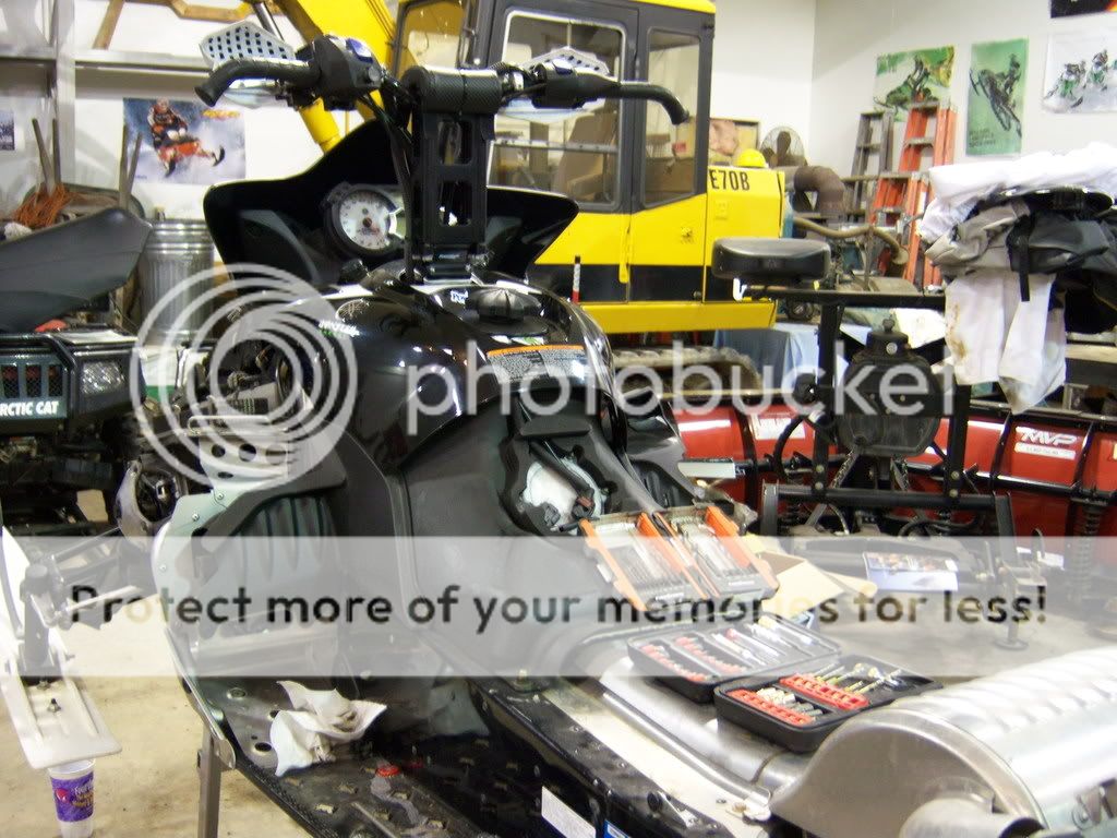

Looks sweet, did you need a different throttle cable for that riser?
Yamaha Man
THANKS MAN!!!
Thats the stock cable with a 9.25" riser.
It works fine...but wouldnt wanna go to much higher. Then you would probably have to get an extended cable.

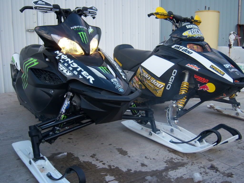

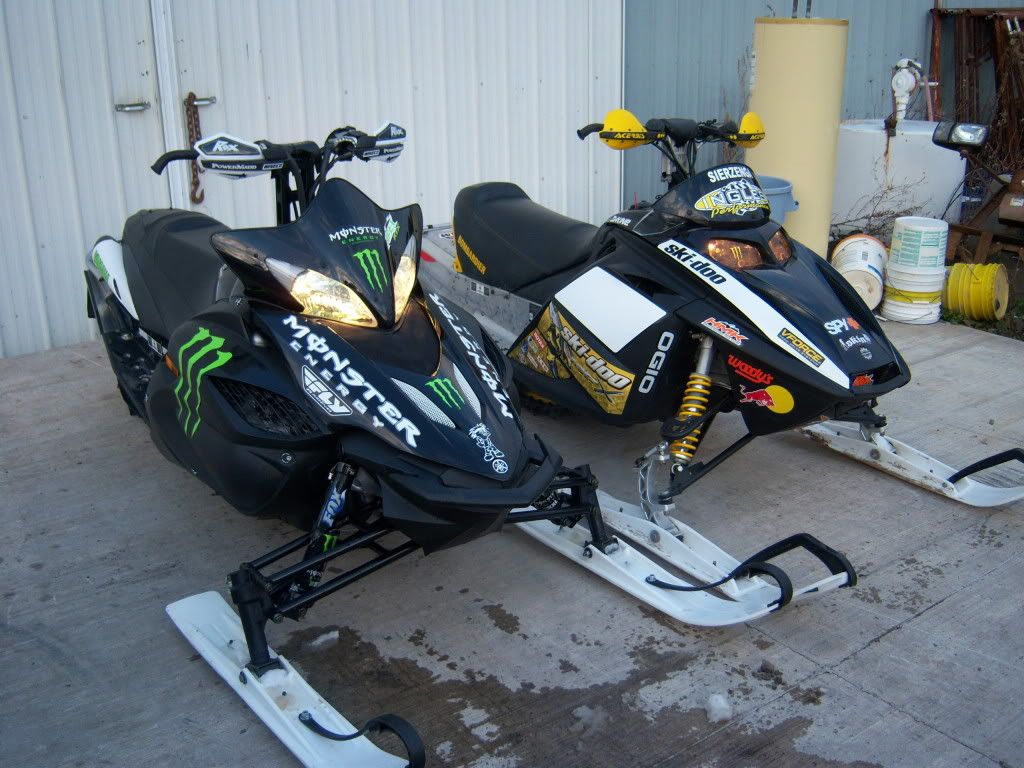

nice man looks awsome! does fartic cat riders ever give you a hard time for having Monster themed yamaha. Because monster sponsers artic cat?
Yamaha Man
ok thank you guys!!! Thats great!! Im so pumped they're up : ) Thanks for your time and effort!! I appreciate the help.
Yamaha Man
never had a hard time with any AC riders.
All my sleds before this one were AC's. I love black/green/white color combos...as you can see, lol.
I get a lot of guys with their mouths open though : P

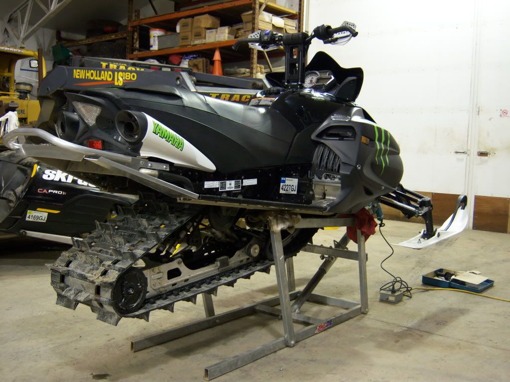

tkuss
I see you use your drill to lift the sled lift up and down. Did you make your own adapter piece to do that or did you buy one somewhere. I Would love to not have to hand crank my sled up everytime I put it on the lift.
Yamaha Man
I built the lift. Im pretty good with my hands and had seen a couple of buddies designs and went from there. Did some improvements along the way too ; )
Got the trailer jack and took of the hand crank and now I just put either a right hand drill or a cord drill with a key and lock her on and it works great! You just got to be careful you dont get the drill ripping around and then come to the point and max out the jack and brake it. It could be easily done. lol But yes the drill works wonders...and saves your arm for sure!!
