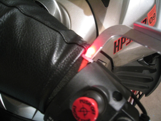

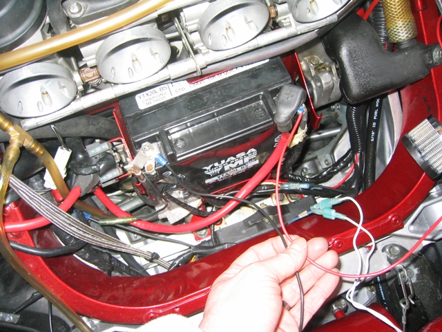

Hey guys,
Got a chance to install Rockmiester's yamaheater controller. I just got to say the install was cake even though I had to run my own power and ground wires and once installed it works as advertised and the grips got HOT sitting at idle, this is what I have been dreaming about since back when yamaha had warm bars!
Overall this is a stroke of genuis and offers a no compromise product. Unlike resistors, aftermarket warmers, etc they all give up the factory control or waste heat through a resistor disspiating it vs going to your hands. Now if you have your warmers on high and they aren't cutting it simply toggle them to off, watch the LED for full RED and you will have toasty hands even if your stopped looking at the map (the stock ecu cuts to 10% power!).

So everyone knows, the unit must have a ground, the ground can go to any good ground on the frame, doesn't HAVE to go directly to the battery, yet looks great!

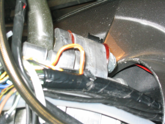

Kinger,
Did your yellow w/red stripe wire under the pad have a female connector on it? Did you use the orange "y" cable that came in Rock's kit?
I was looking to wire my controller on my 07 RS Rage and found that the yellow w/red heated grip wire under the pad had a female connector on it. So I dont think I need to cut the yellow/red wire and use the "y" cable from the kit. What did you do? What am I missing?
Also, I think I am going to mount both the LED and switch on the inside flange of the right grip switch housing. There is a 3/8 - 1/2" flange on the inside edge left of the thumb warmer switch that I think will be a great place for these. This is right where you have your LED sticking out from the the pad.
Thanks, G.B.

Gone Blue said:Kinger,
Thanks, G.B.
Are you saying there is a bullet type snap connector on the warmers at your bars GB?
If so, you are correct, no reason to cut anything!
Nor do you need the "Y" cable.
Would like to see a pic if possible.
Nope my connection was like a two wire connection that split into the bullet connections going to each grip. If you have a bullet there go for it no cutting!
I cut my wire and spliced in the bullet connectors if you dont have to dont do it, just need to get to the 12V source from the ECU, be great not to have to cut a wire. Post a pict!
I think that is what I will do next year, mine is only temporary since I leave for a UP trip in 1 day.

Thanks Kinger, There seems to be more difference between the RX and RS than I thought. My 07" RS apprears to have the grip warmers wired in series and the yellow/red wire from the ECU feeds only the left grip which then feeds the right. I dont know about your RX, but I think the only place to tap into the wiring harness is under the pad. There are no other connectors or enough slack in my harness to get at it. I plan to document my install for Rock on my RS and will post some pictures as well. Thanks! G.B.

I am wondering where the fuse is. There should be one in the red wire off the battery, as close to the battery as possible. I guess I missed seeing it. Fuses are especially imporatnt on non-factory wiring as it is typically the most suseptable to not being fastened down correctly.

Len - There is a 10a fuse in the kit, its located under the bars, again temp for this year and I will clean up when I re-do everything in the off season and move it closer to the battery. I'm getting a MPI so all thing electrical will be moved anyway.
