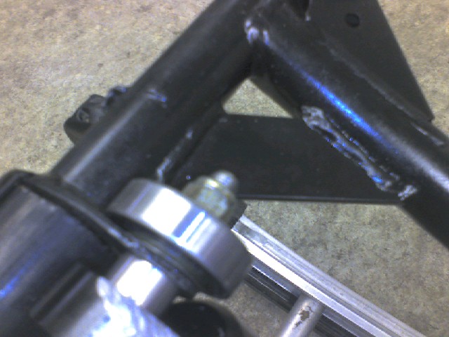

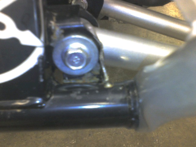

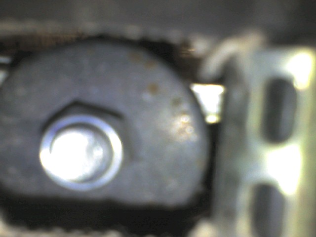

Yamaha Rear track tensioners like to break and come loose. This will cause your tension to be loose. If you take a big fender washer and install in front of the tensioner nut this will provide extra support to keep this from happening GL!

Add a bearing and longer bolt to the upper shock mount to reduce the track drag against the shock and allow studding of the center belt.

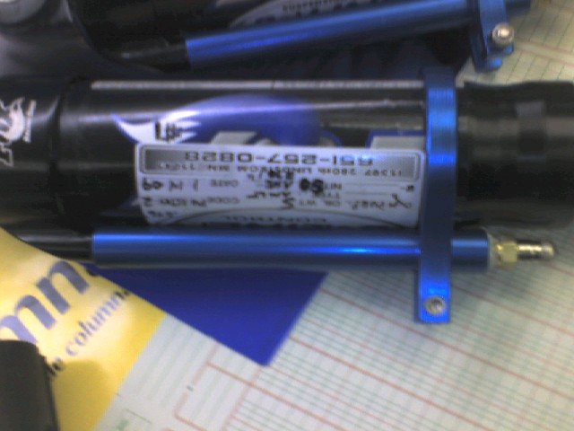

Invert the front track shock to take the sprung weight off the skid!!! (may require Machining from your suspension guy)

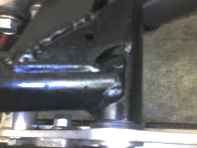

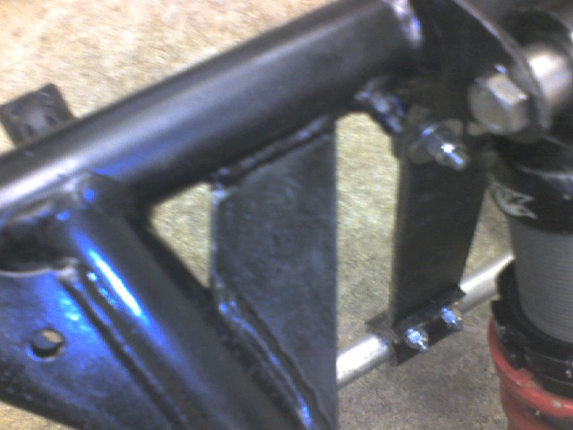

Front Torque are needs some additional braces to keep it from bending email me if you need pictures.

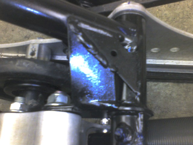

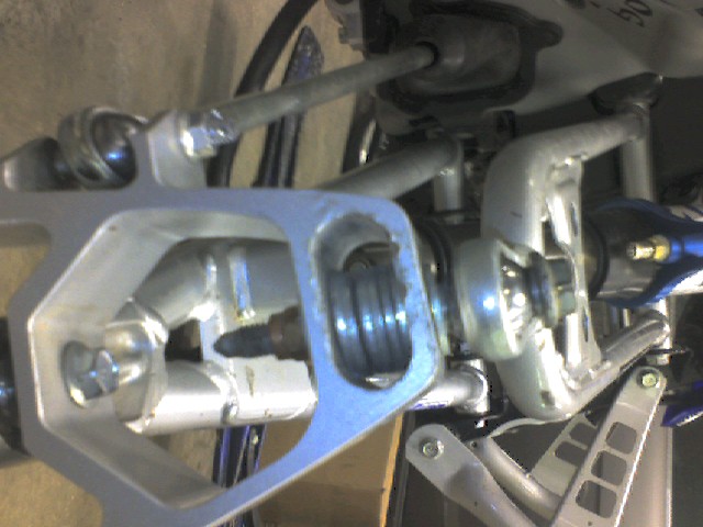

Remove the stock A-arm bolts and Add large washer to them this adds additional support in the weak sub frame area. You will also see two holes in the front spindle run a longer bolt for the upper ball joint through both holes filling the gap with washers. This allows for more support to the weak part of the spindle.

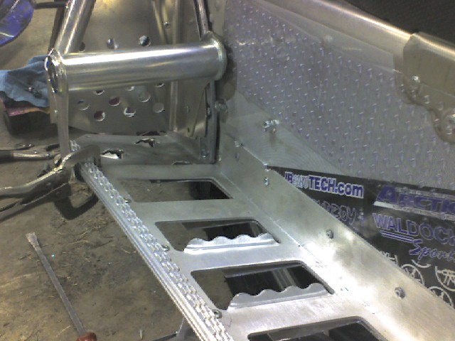

F-Bomb Racing makes some nice Running boards to help with the snow buildup!!

Put Big washers on never broken a tension even on some hard tail landing in Snox

Hey yam what do you mean turn the shock upside down?

Weapon X said:Hey yam what do you mean turn the shock upside down?
Yeah what he said? Does this mess with valving from where the oil sits in the shock?
Weapon X
Ya thats what I'm wondering does the oil leak down past the shim stack when it sits for awhile.
A gas shock can be put in any position so his advice is good.Shaft down would be least wieght I think.Kind of a toss up with wieght of spring -vs-aluminum bodied shock with oil in it.

Suspention guy told me that it was to get the sprung wieght off the skid, to be honest its a very minor mod, but I let my suspention guru have full run of what he did to the skid!! All I can say is with the fox shocks it works great

Wich shock do you flip?
