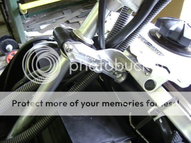

Well, CR's is 40.00 + shipping, does anyone have a pic of WC kit??
sledsearcher
Here is the Wildchild:

Will it make much of a difference though? I'd be looking for something that reduces the ammount of jab you get in a hard turn..
skidooboy
the relocator puts the bars at a more natural feeling position in my opinion. no more turning the bars and have them stuck in the front of your thigh. ski
Nikolai
Everything wildchild builds looks great and is bullet proof. I have one on my Nytro and wouldn't hesitate to spend the extra coin if I bought another one.
Alatalo
- Jan 11, 2005
- 1,420
- 973
The purpose of the Wildchild kit is for sure to improve the handlebar position for mountain riders on MTX, but it also works well for stand up style trail riders on RTX. I installed the Wildchild kit couple of weeks ago, with the stock riser and the stock handlebars in the most forward position. For me, this is the perfect handlebar position for stand up style riding across moguls. It also improves the steering, because it brings the rider weight more forward when turning.

Yes I noticed if I lean forward over the bars in the "attack" position its much easier to turn and acelerate, the only thing thats sucks is the bars in your way......wallaa the WildChild kit!!!
Bodacious
Is the changeout done all on the top mount, or is there something to do down below too?
Nikolai
Not sure about CR's kit, but wildchilds has a new lower bushing half you need install.
Alatalo
- Jan 11, 2005
- 1,420
- 973
And you also need to bend the lower bushing bolts 1/8" downwards.
