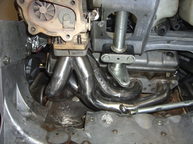

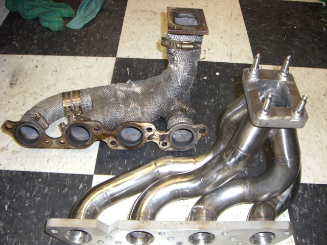

Well after getting a new header from Need for Speed/ kevin E. Getting to finally get to work on the sled. Got her tore down, again, tonight and rough fitted every thing while I wait for gaskets.
Right now I have to modify the down pipe, nothing big. just have to cut the flange off and change the angle a few degrees. Trying to get her done for this weekend but we will see, I am not holding my breath on that one.
Just getting everything on and tested, then full tear down and send everything out to get swain tech coated and different exhaust for next year. Along with powderlites stage 3 Intercooler, and bigger injectors. New hood, and modified air intake.
And finally getting rid of the POS speed track for something that will bite better in the snow.
heres some pics

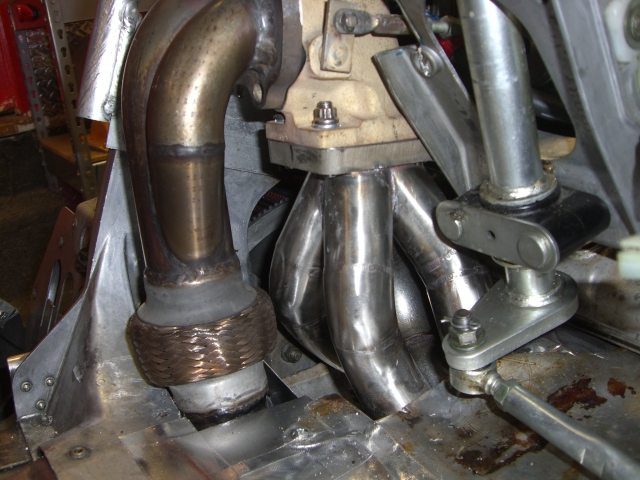

Got her all fabbed up and bolting everything down. Worked on some RB3 maps and we are getting there, should be ready to test this weekend.
The only hiccup now is, I didn't have the typical wastegate rod hitting the fuel tank issue, after the install of everything it sits right on the rod, I am going to rivet an alum guide off the steering gate right above the WG rod to push the tank over the 1/4 inch I need. That should work Fine.
Also I re did all the heat shielding on the fuel tank and put in a 90 degree piece of aluminum along the edge of the tank where the rod could possibly hit.
Got the down pipe rewelded and have plenty of room now. Just had to cut back and bend the tube under the tunnel to match the new placement on the down pipe.
One thing I can say though, is I put my CPR header on twice on this sled, and did my old mans Powderlites header bolts on his sled. This 4 tube header took about 5 mins to install and have turbo mounted. !/4 drive with a swivel socket and didn't even have time to drink a half a beer.

Well got her all back together and finished up. I didn't get to take any pics of the bracket I made off the steering gate to hold the tank off the wastegate rod, but when I tear down again I will post it. It worked out perfect, I now have about 1/4 inch clearance.
The only thing that come close is the steering arm comes real close to hitting the header, It does hit the heat shield right before it stops out. Nothing serious though.
Also to to modify the heat shielding for the bigger header. Nothing to bad just some new bends and some new rivets.
and I added Jannetty Water hose and fitting kit to the turbo, Hopefully I will stop melting coolant hoses.
There is plenty of room between the gas tank and down pipe. And I installed 3 layers of the heat/fiberglass stuff through out the whole area.

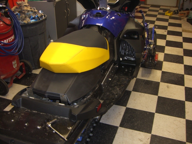

here we go again, a long summer of modifications, After looking at RXriders post about using a rev tank I figured I would give it a whirl. I found a ski doo XP seat and tank. 10.6 gallons of fuel and good placement.
Got her rough fitted and I think i will work great. Just have to change exhaust, and move the mounting bolts and fab up some brackets to mount the tank and side panels. Then I am thinking some black neoprene to fill in the front of the seat down to the side panels.
All this and there is tons of room around the header/turbo now. Enough room for a mid mount turbo.....HHHHMMMMMM

plus without fuel, its about 10-15lbs lighter.!!!
any one have ideas on what else to cover in front of the seat, and or Exhaust???

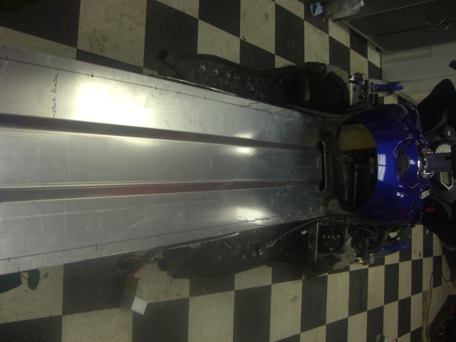

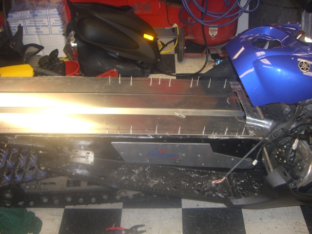

Cut the tunnel up in pieces today and fitted the tank to the cowling, had to make some cuts, and move the tank more forward then I wanted to. I wanted the fill to be centered in the same cowling hole, but didn't have the room. So about 2-3 inches forward it went, Now I just have to get some plastic and make a plate to cover the old hole.
Trimmed down the side plates and they will work fine...
Getting the tunnel piece bent up on Monday to still give room for the exhaust to go in same place for out the back muffler. Might have to go with two 1" 1/4" pipes instead of the single 2.5 pipe that was there. That is going to make muffler selection real fun.
If any one has some input on this or different Ideas let me know... please...
Also going to change the back of the tunnel a little, maybe do some diamond plate like my old mans sled, But I will paint it black, to much polishing is not fun....

This seat tank combo is alot more comfortable to boot.. Seat hight is about 2 inches taller and not as soft.
Got my new tunnel piece today, quick call to a friend last night and he bent it up this morning.
Being a boat builder, it is great having friends in the fab world with all the fancy tools and material laying around!!
right now it is still a little long but we are bending up the side plates tomorrow and some added pieces for strength. After that I will decide where to cut her down to. Never know I may have a 144 proline under this some day....??
Should have her ready to rivet up over the weekend, and got my new exhaust stuff coming.
Ted Jannetty hooked me up with pipe and a turbo flange, I got something special for exhaust since it will not fit under the tunnel.
