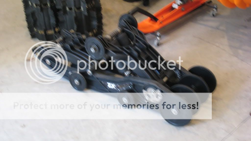

Starting out with my 06 Apex RTX with a ZX-2 Suspension, and hoping to turn it into the Apex Backcountry by the end of summer. Here is a picture of the sled this last winter.
I am going to a 144" long 2" tall challenger track with the ZX-2.

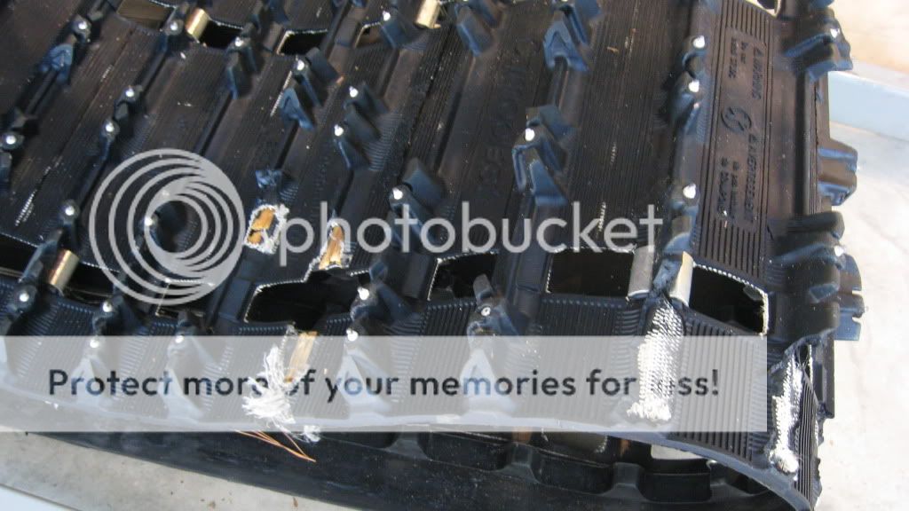

Here is the old ice ripper showing a bit of wear after 8500 miles of use.

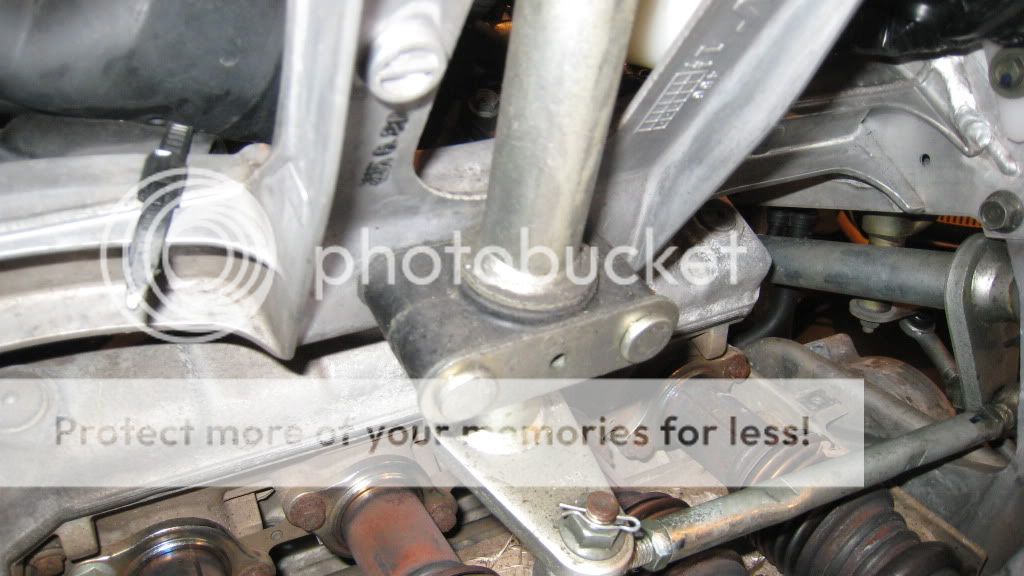

Here are the stock plastic steering blocks.
Those blocks contributed to tons of handlebar slop.
Here I replaced those with the new OFT steering blocks and it got the steering play back close to when the sled was new. I am very happy with how much these blocks helped with the steering play.

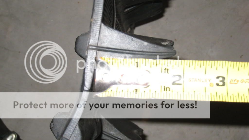

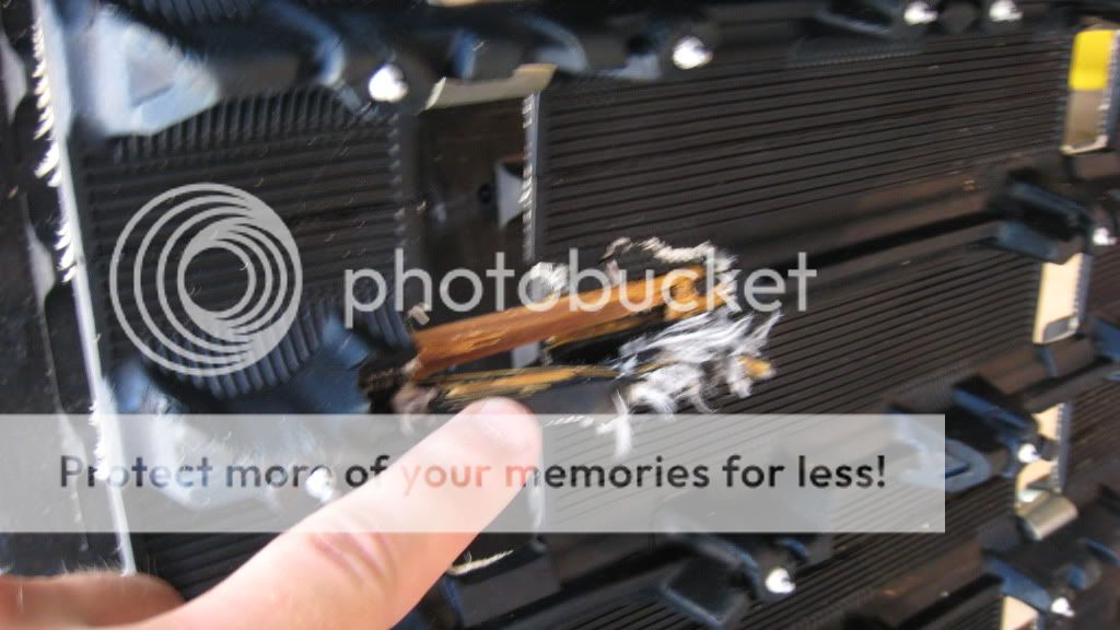

Here is the challenger track. A bit under two inches. After I head out west next year I plan on cutting it down to a bit under 1 3/4 inches.

Wow the rear wheels on a ZX2 are huge. I never noticed that before until I seen them in your picture off the suspension. What size are those?

You have two inch lugs there. You just measured wrong. I do believe you have to measure from the inside of the track. I have done so forever. Your track would measure exactly 2" if you went from the inside. Thats my .02

Jeremy is correct

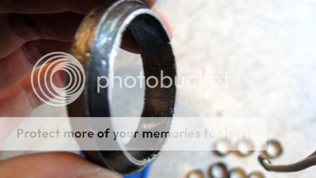

I have replaced the exhaust donuts, the ones that were in there did not have many miles on them, but I wanted to replace them anyway so I could do it myself next time I need to in winter. Here area few pics of the old ones and new ones.
Flex pipes
New ones
Old ones

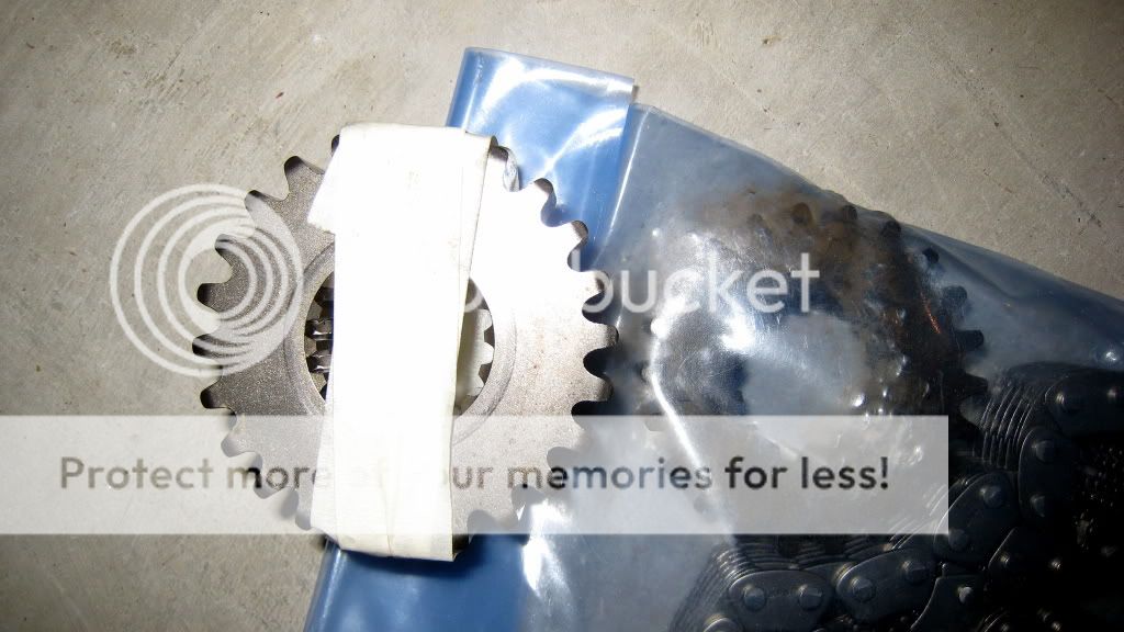

Here are some bad pictures, I will get better ones later. But there is the new 22 tooth top gear I am replacing the stock 24 tooth with in order to turn the big track. Also the lower gearing of the 8tooth drivers should help with that.

yamahaboy701 said:Wow the rear wheels on a ZX2 are huge. I never noticed that before until I seen them in your picture off the suspension. What size are those?
Yes one of the benefits of the ZX-2 is the huge 8" rear axel wheels they use. Hopefully they make up for the inefficiency's of going to a smaller 8 tooth driver.
