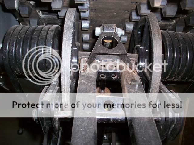

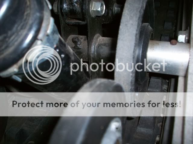

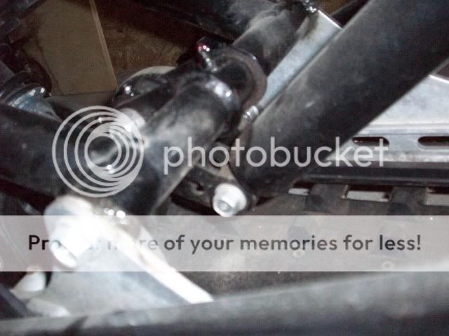

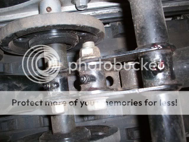

nightsniper
ok heres a few pictures, there doesnt seem to be anything broke, but maybe you'll notice something else.
jlparker77
definitely can't see anything bad. nothing obvious to me anyway. My next step would be to pull the whole skid out of the sled and check all the cross shafts to see if anything is bent or seized. And check any bushings that could be worn out. Also, these sleds are very "droopy" with the suspension. What you consider bad when compared your other sleds may be normal for the phazer. If i push my back bumper down on my 08 and let it back up, it stops about 4 or 5 inches from being all the way up. Been like that since new.
