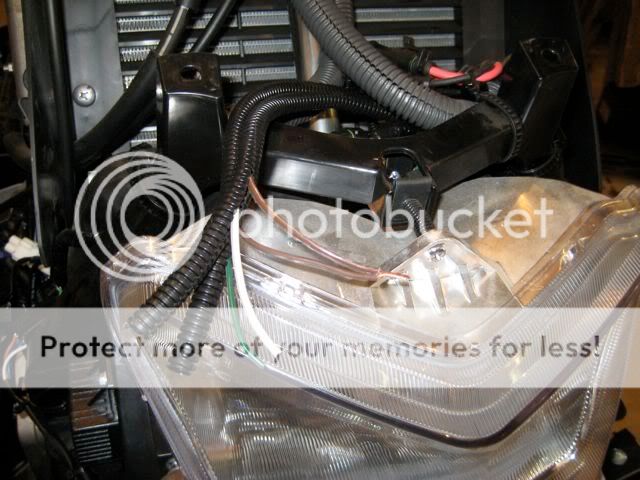

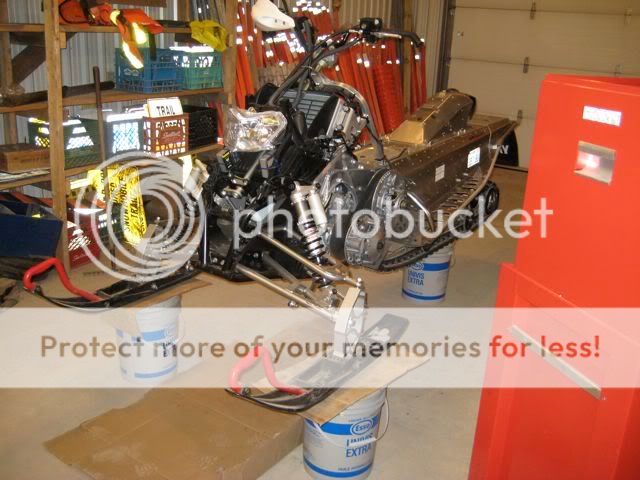

Here is a little update on the progress....
Graphics are installed
HID's are installed
ROX Riser is installed
Gauge Pods and Gauges are mounted, but have to be wired yet along with mounting the senders.
This week I plan too
1) Mount all the senders for the gauges
2) Wet Sand & Polish the tunnel
3) Mount my White Skinz Float Plate
Here are a few pics from last night stripping the sled down to get ready for the wet sand and sender installs.
HID's are installed

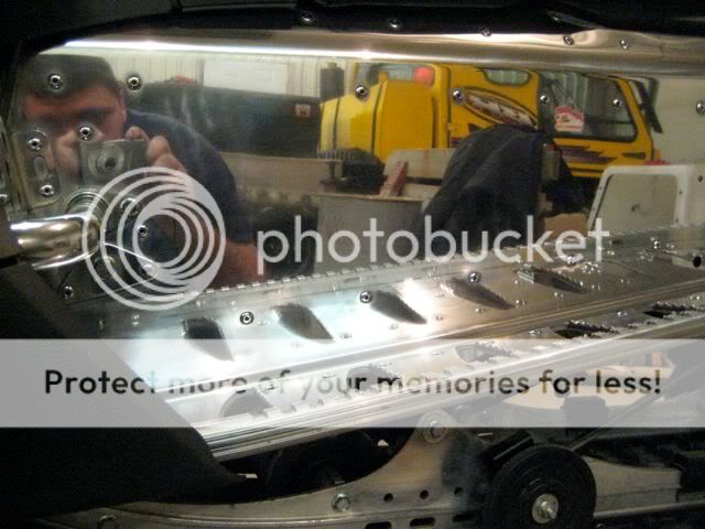

Well boyz..... Made some more progress on the sled lastnight.
Started the wetsand, big thanks to my buddy Kevchev for helpin out with the arm work...
This is with 1000 grit wetsand ONLY....

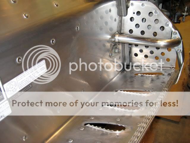

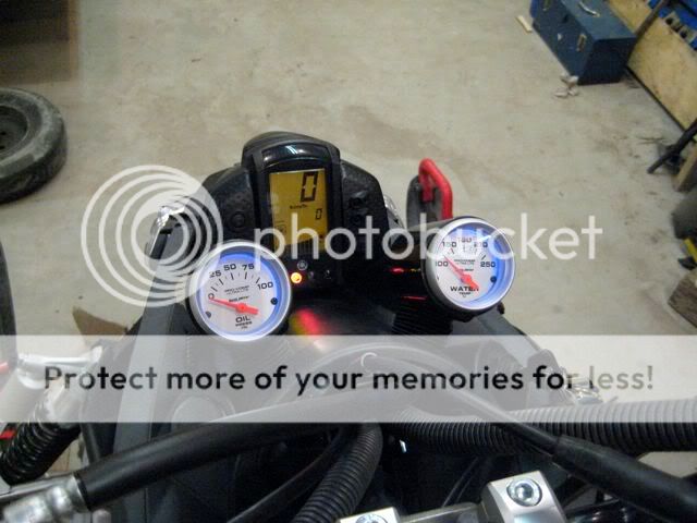

Well another night of working on the sled, another few things done.
One side of the sled totally done with 2000 grit, and the first initial polish of that side, I figure I'll polish it 2 more times and then seal it. I was gonna do the other side, but I got bored and wanted a change of scenery. So I figured I would wire in the gauges and install the senders.
Working on the 2000 grit wet sand..
Starting to polish, comin out pretty good
Bored... Time for gauges!
More to come...
More to come...

The blue on the gauges look great!
TVBrian
- Mar 17, 2009
- 197
- 196
- Port Perry, Ontario
- www.portperrysnowmobileclub.com
Bamboo said:The blue on the gauges look great!
I'm hoping to find a way to carry that blue over to the stock display also.... Have to find a schematic to see how it is lit!! Then maybe if it is LED or something I can swap them for blue.... SWEEET!!
