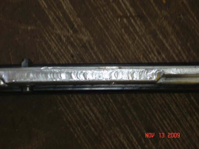

My rails cracked for the third time, I had one of my friends beef them up a bit. What do you think? Will they hold?

Have done something similar in the past with success. If they break again, it won't be where you added the support. :) Nice job!
If you are breaking rails, you are abusing them. Mine are perfect at 11,000 miles. If you have a new sled, and run into a tree, it's not the sleds fault.
That looks nice!
That looks great, only thing differently I would have done is sandwich the stock rail with a piece of aluminum on both sides like you did on the one side. That's nice welding if you did it yourself....heliarc pro huh....LOL.

Huh? At least with the 136's, it's a design flaw, very common for 'em to crack in that area.
Mine cracked first, and now my wifes are starting.
It seems they crack more often after a re-valve, instead of the shock bottoming and your back taking all the pressure, the shock absorbs it and it all gets channeled through that point.
I was thinking about doing that, but I didn't want to cut anything off the rear arm and having less surface area for the bolt to grab on to. I didn't weld it, a bunch of my friends are iron workers.
