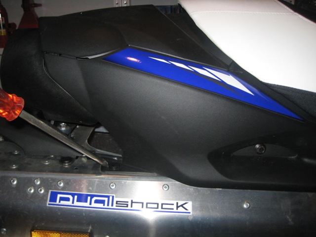

Tear down body panels
Starting removing the bolts on the seat side panels
Then remove the plastic clasps on the tunnel at the end of the panels (2 flat small screwdrivers works well)
Pull a little back the panels and than turn it up looking to the front joint (in the red circle)

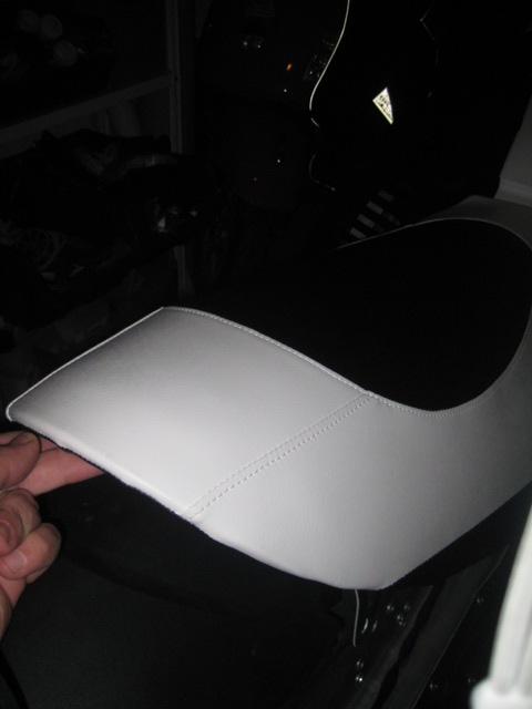

Now remove the seat by removing the two bolts (1 per side) by a 12 mm wrench.
Than pull up and back the seat
I’m boring myself but I prefer to catalogue each part I tear down by a piece of adhesive paper

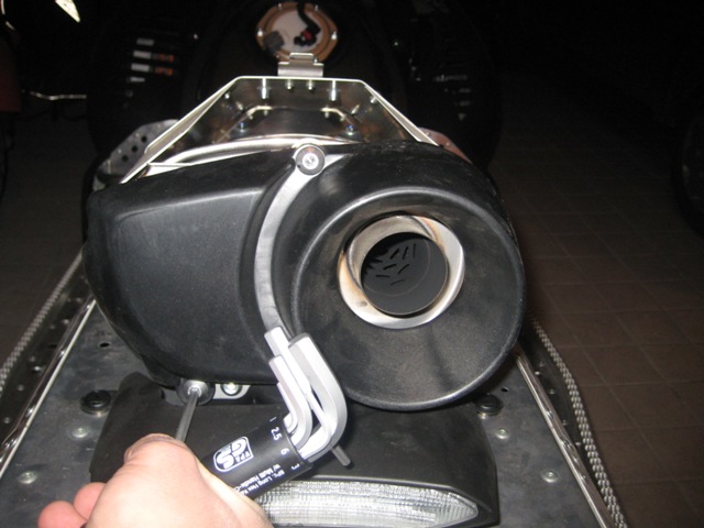

For The top cover of the exhaust just need a big cross screwdriver
The end cover of the exhaust need an allen wrench (1 bolt up and 2 bolts down)

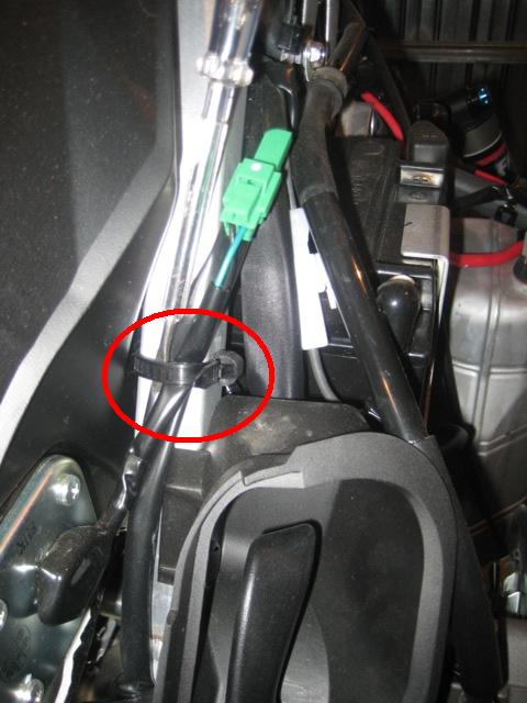

First remove the 2 fasten band on the left of the reverse handle (don’t cut, they can be opened) so you can free the cable.
Than disconnect the white connector and free the cable around the thank and along the tunnel.

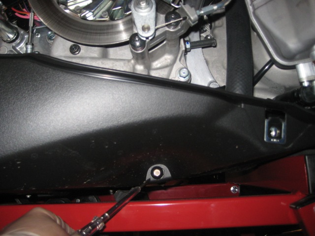

Is now the time of low side panels (sorry I took some pics from right side and some from left side).
Starting from the footrest remove the clasp, the bolt (10 mm wrench), the clasp rear the shock, and the clasp over the shock.
Now go under the engine and pull out the 5 clasps (1 in front and others on the sides)

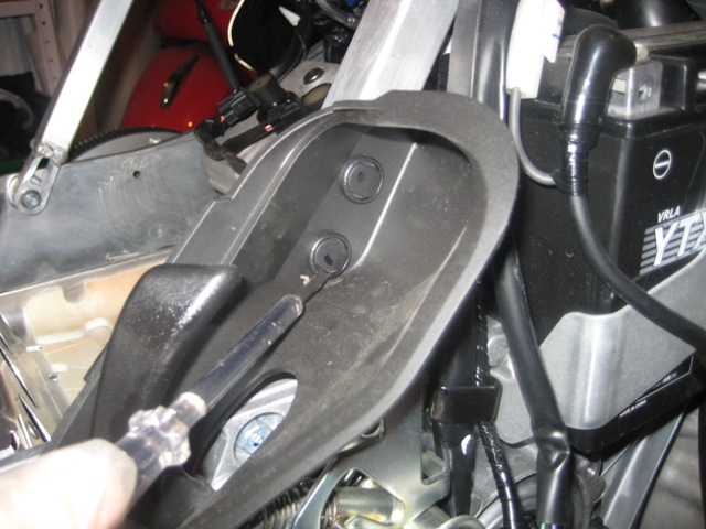

The upper panel with the instruments needs to disconnect the white key connector on the right side (with a gray cable) and the big black connector coming from instruments. Is helpful to open the fasten band close to the balck connector.
Than remove the clasps and the panel is free.

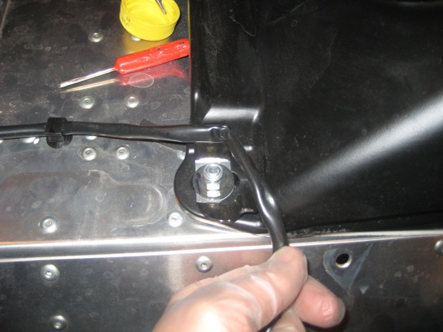

Tear down the tank
Disconnect the gray connector
Careful ly remove the black security plastic cap and free the red clasp

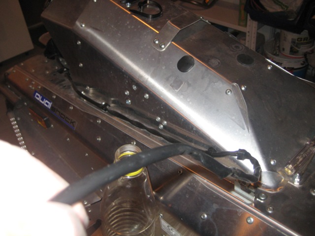

Now you can disconnect the pipe (keep a rag in one hand because a very small quantity of gas came out)
Free the drainage line from the left side fasten band and from the right side pay attention to routing of this line
Disconnect the pipe from the top of the tank and from de left side footrest
Than you have to disconnect the cables.
Than disconnect the white connector and free the cable around the thank and the green connector

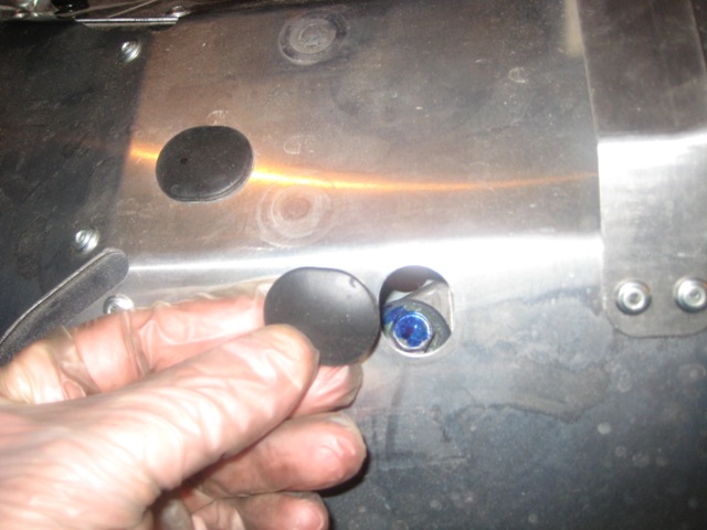

Is the time of the 2 bolts on the rear of the tank. On the right one there is the metal clasp of the rear light cable.
Now you can pull out the tank.

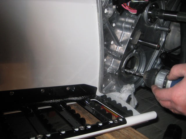

Tear down the chain case
First drain the oil
Remove the stationary brake by removing the 2 bolts with an allen wrench
Remove the calipers by the 2 bolt on the rear of the calipers and free the brake line by removing the bolt on the clasp

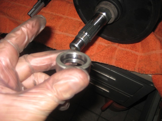

Remove carefully the circlip the 2 thin washer and the the brake disk
Now remove the small spacer and free the big spacer and remove it
Pay attention to this very very small o-ring you’ll find after removing the big spacer.
This is the sequence of objects (you have to add on the right the above small o-ring that I found after this picture)
Free the reverse link
Loose a little bit the locknut and remove the chain tensioner bolt
If you sign the position of the locknut, you’ll save time when re-install it.

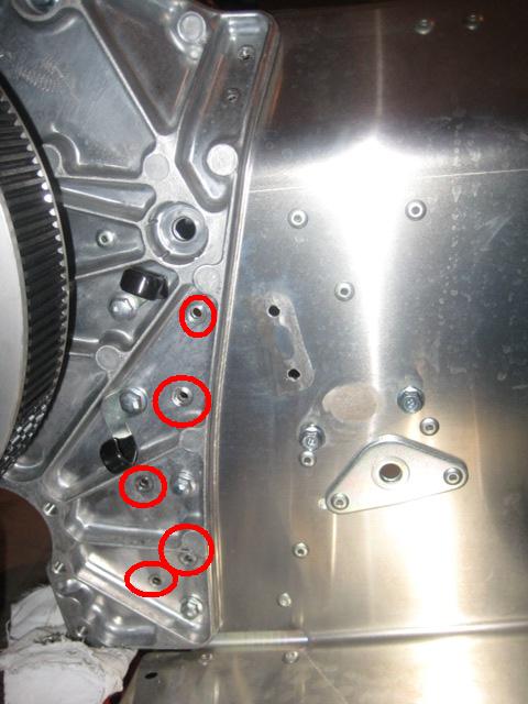

Loose the bolts of the chain case (also the two black ones in the middle) and remove it.

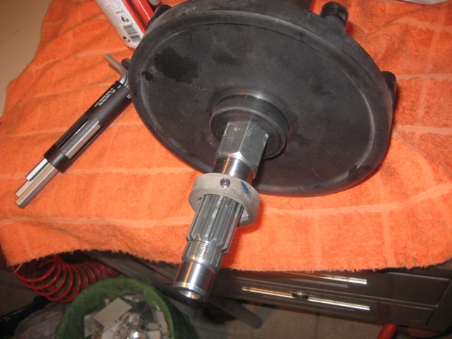

Remove the big spacer on the upper axle
To be sure not to lose something I keep together the ‘friends’ of the upper axle
Remove the external small gear paying attention to the small spring between the two gear
Remove the chain tensioner
Remove the drive axle bolt keeping firm the axle with a wrench
This what happens when you keep out the bolt
Now pull out the first gear
Then the second gear and the washer/spacer on the behind (look at the form)
When you pull out this, you keep out also the chain, the middle gear and the upper gear.
The sequence of the upper gear
The two washer are concave and the the chine go against the gear
The sequence of the middle gear
The sequence of the down gear
The work is done

Tear down driveaxle

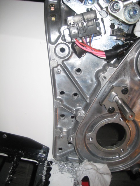

Starting with unbolt the three bolt on the right side.
Than on the left side there are 6 bolt (2 keep also the speed sensor).
I don’t know if this can help me in the future but I prefer to make a mark for the re-build.
Pay attention that the two lower bolts are shorter than others
I work alone and one difficult I met was to have the axle out because of the drivers jam on the track.
So I tied the track to the steering column passing a nylon belt trhough the center exhaust hole.
The axle free from track come out easy pulling from the left side
Left side items
Right side items
Drive axle
Left side items
Right side items
Drive axle

Drive axle disassembly

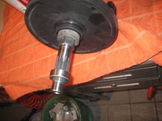

This my rtx axle
Before disassembly, mark the drivers position
On the left side (from the rider point of wiew) unbolt the bolt on the head and extract the small gear.
Loose with an allen wrench the ring and remove it
Now you can remove the plate
On the other side remove by hand the spacer. Pay attention that in the inside there is a rubber o’ring.
It seems to me that is better to put a little of oil on the axle to make easy to the o’ring to slip
Loose and remove the ring
Now remove the drivers just with brute force
I found a system to do that here it is
May be it is not the best one , but it works
This my rtx axle

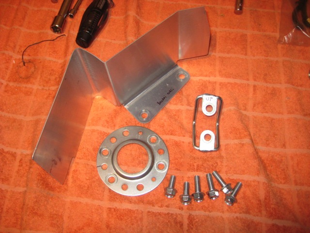

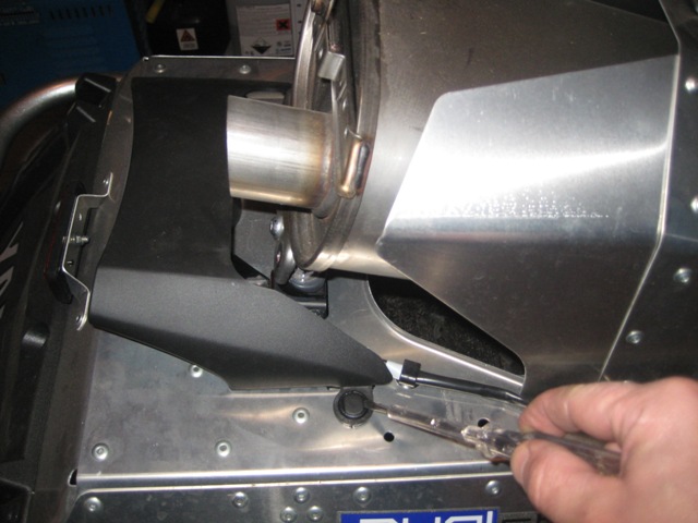

Exhaust

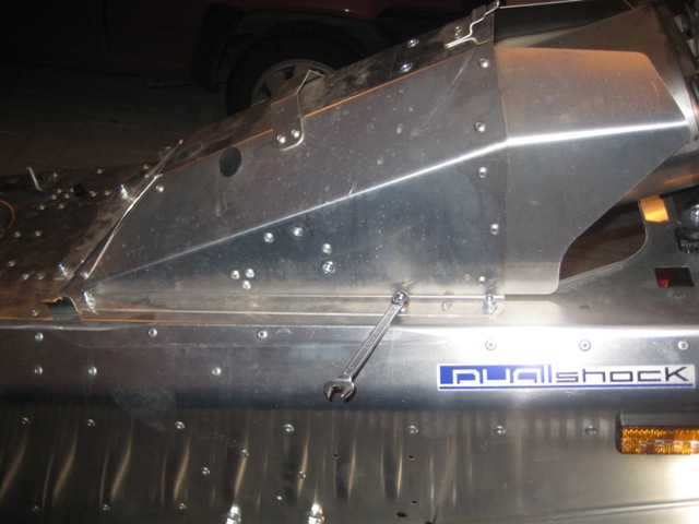

Remove the 2 rear bolt by an allen wrench

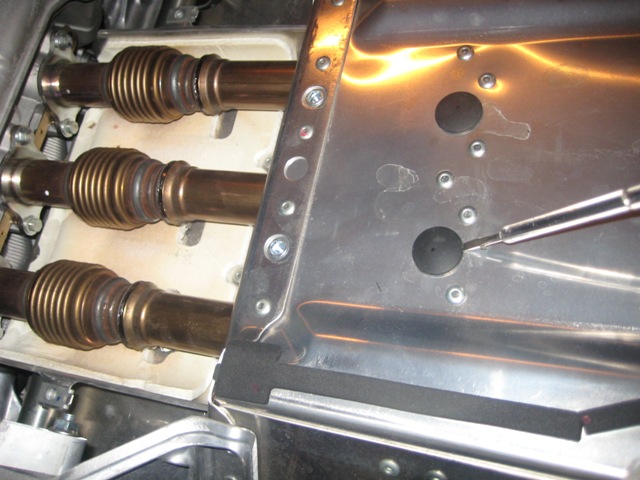

Remove the three rubber stopper on the top of the cover
From those hole you can loose the collar between the manifold and the silencer. The other two free the silencer
Then unbolt the bolts around the exhaust cover pay attention to the position of the metallic fasten on the right side
This is your step
Now remove the front plate by the 4 bolts (2 in the rear and 1 per side)

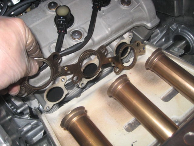

You need an allen wrench to unbolt the three manifold collars
Than open them and remove
Remove the 2 rubber stopper and unbolt the manifold
Pay attention to the three soft gasket… they are very easy to be damaged
My sled is brand new and working carefully I’m able to use them again
Unbolt the link to the engine side and carefully remove the flexible links between the engine and the manifold. Pay attention when manage the gasket that is very thin
Close the exhaust exit of the engine to avoid entering dust or objects
This is your step

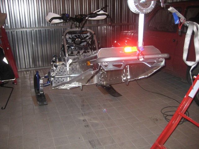

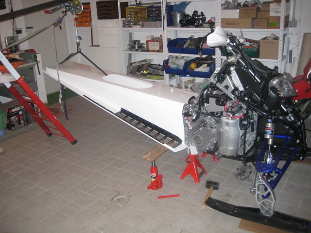

First support the front of the sled with stands under the bulkhead (the picture is take from the last step but is good to see where to place stands
Then support the tunnel in the front (I used a small wood table with 2 stands) and in the rear to avoid it fall down when you keep away rivets and bolts (I forgot to take a picture but is the same way I used for install the new tunnel)

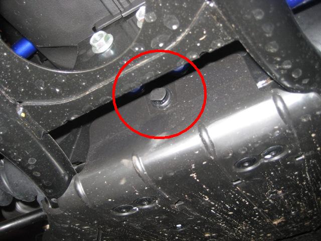

In the picture there is an error. The top bolt is wrong, it’s the place to bolt in the footrest.
