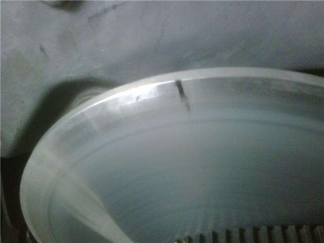

Testing results from today:
I switched from the new belt (was the spare when I bought the sled with 1100 miles) to the old belt that had the original miles on it.
After the shaving the 2 grams from each weight the RPMs are much improved. Pin it and the R's jump to 11,800-11,900 and fall to roughly 11,660 everytime down. The over-rev is pretty quick as it doesn't sit at 11,660 for very long. The sled over-revs right back up to 11,900. This was consistent with both belts. The first belt today (new - spare belt outlined above with very low miles on it) saw these RPMs but neither clutch was shifting out all the way. Ref the pic below of the primary.. the secondary was looking about the same. The MPH was 78ish with this belt. When I put on the belt with 1100 miles on it... it was a bit better at first but seemed to warm up nice. The R's were the same with this belt but I was over-reving and pulling up to 84 on the speedo. I haven't pulled the belt to take a better look at the secondary but I can't find the mark on it at all now... so it must be shifting out. I'm still concerned with the primary though. It just looks to me like it's not shifting out.
Looking for some benchmark pics or tips here. Mark your primary and show me a pic of yours... or just take a pic and l can check out the wear mark and see how high your belts are riding.
thanks
thanks

I'm in B1 on the secondary
