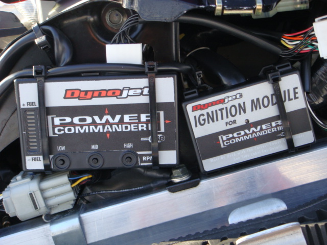

Hi, does anyone have a copy of, or link to, or pictures of installation of the ignition module and multi-function hub to the PCIII on an Attak?

i have the pc3 install and ign module....but dont have the hub.

Thanks Dan, exactly what I needed. I appreciate your time, effort and help.

I think I've got it figured out, pretty straightforward. Connect igniton to PCIII, hub to ingition and the switch cable is the only 3 pin connector coming out of the hub.
