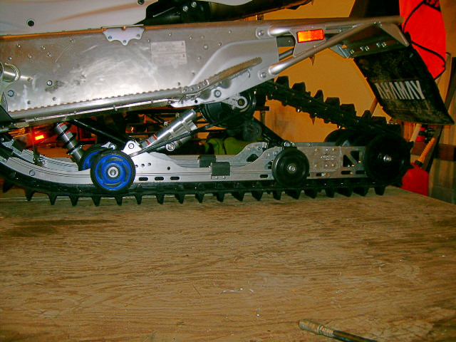

I forgot about the polaris wheel mod - I replaced the front skid wheels with Polaris 5.35 wheels inside and out and then also added a set of yamaha wheels in the rear outside of the skid - all in all I believe this has corrected the hyfax wear issue - we rode dozens of miles on forest rodes and while i could smell the hyfax, there is no noticeable wear on them at this point and i have more than 500 mile son them,

woolyviper said:I forgot about the polaris wheel mod - I replaced the front skid wheels with Polaris 5.35 wheels inside and out and then also added a set of yamaha wheels in the rear outside of the skid - all in all I believe this has corrected the hyfax wear issue - we rode dozens of miles on forest rodes and while i could smell the hyfax, there is no noticeable wear on them at this point and i have more than 500 mile son them,
are the wheels the same shaft diameter or do you swap everything including the mount ???

i replaced the front small wheels in the suspension - i had to take 5 mm off each side of the cross mount with a grinder -Jeremy said:woolyviper said:I forgot about the polaris wheel mod - I replaced the front skid wheels with Polaris 5.35 wheels inside and out and then also added a set of yamaha wheels in the rear outside of the skid - all in all I believe this has corrected the hyfax wear issue - we rode dozens of miles on forest rodes and while i could smell the hyfax, there is no noticeable wear on them at this point and i have more than 500 mile son them,
