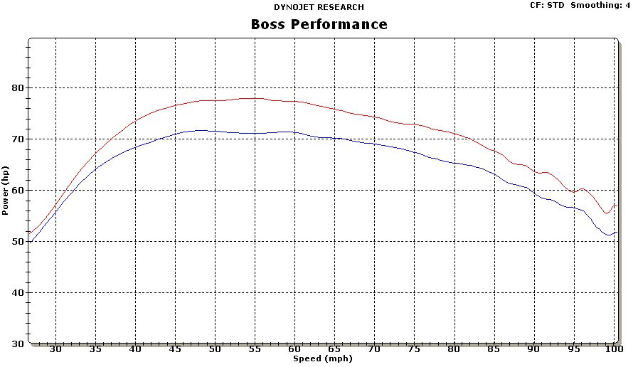

Hi everyone. We have been busy testing, tuning and testing some more. The following graph shows some of the performance gains that we were able to achieve over a stock Nytro. The graph shows a stock Nytro vs a clutched Boss performance Nytro.
For this test everything else was stock besides the clutches.
We will be offering a "stage 1" which includes weights and a primary spring.
A "stage 2" which includes weights, primary spring and helix will be limited right now.

which weights scott?
ptt
Guest
drag & fly weights

Im running your setup for stock nytro, but I have now done the full excell, K&N, and pc111, I have only put 225 Kms on and I was hitting the rev limiter a couple of times from a dead stop, not right away as I was hooking up. It happened at 100km/h plus (only in a drag race), unfortunately I never got a chance to hold her open for any length of time, I am thinking that I will need to add a washer to the heel....keep us posted on what you find to work...thanks
