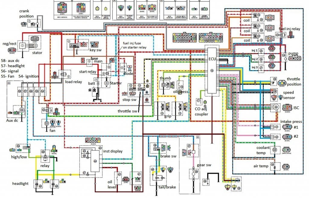

Wiring schematic:
*See PDF file attachment for download*

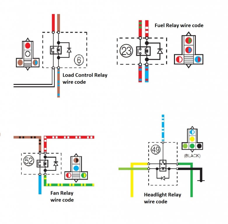

Nytro Fault Codes and Relay Location Diagram:
Relay locations (2 - 5) may vary, See relay wire code diagram for correct positioning.
Relay wire color code

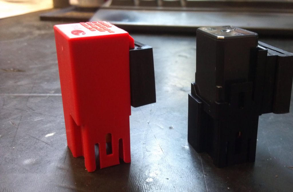

New for 2014 is a new solid state fuel relay (old relays were mechanical - moving parts) - the new solid state relay has no internal moving parts so sticking when cold shouldn't be a problem. The part number on this new relay is 8GN-81950-00-00 and it can be identified by its red casing. The new relay has the holder part built into it

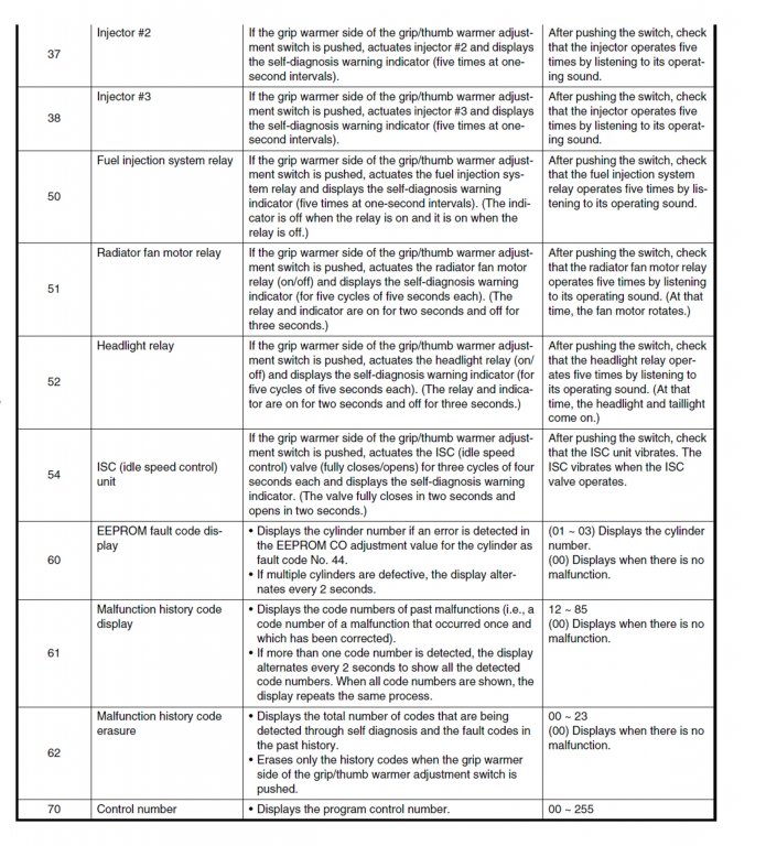

Diagnostic Mode:
Diagnostic Mode Codes:

Diagnostic Mode:

diagnostic code number 62. if i have a code flashing on the sled can i erase it with this procedure
Nytrider109
yes please
