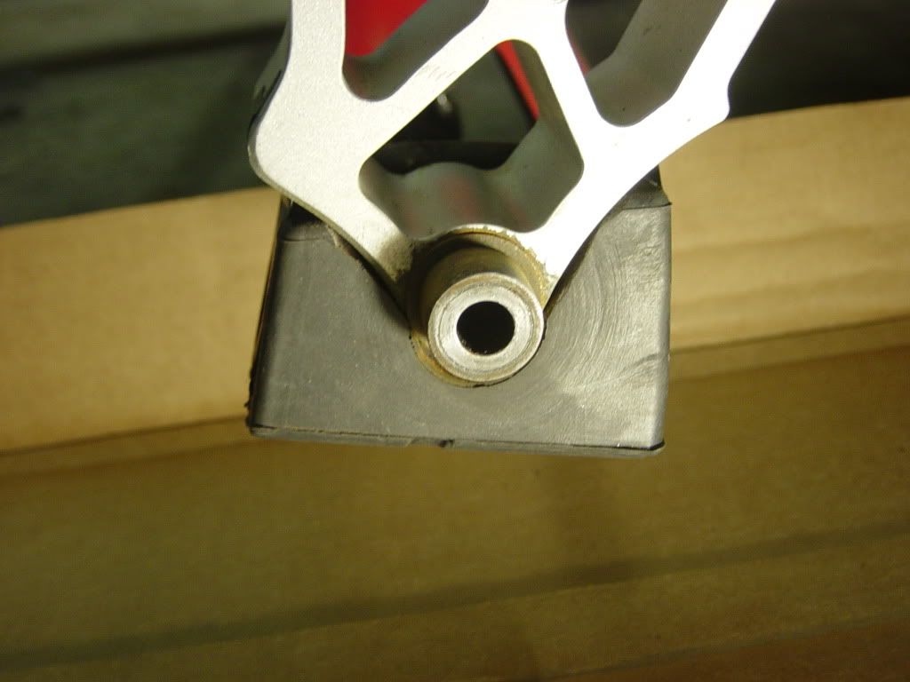

Just did my ski install and had all my shocks revalved by Pioneer Performance. Now all I need is snow to test out the setup.

Are you using stock rubbers?

no, they are the skidoo rubbers. go to the photobucket link for more on the rubber stoppers. http://s589.photobucket.com/albums/ss33 ... ot%20Skis/

Where did you get the rubber stopper from?

larrypolaris said:Grizz,
This is what I ordered from Honda East Toledo
http://www.hondaeasttoledo.com/
Order:
Qty. Part Number Product Name Price
1 505072479 PILOT SKIS $78.84
1 505072478 PILOT SKIS $78.84
2 506151233 Skidoo - STOPPER $19.98

I have the 6.9 pilots on my XTX. These skis really made the sled easier to steer plus they float great too. I also have the Hygear triple rate springs on. The sled handles awsome, very little push, and very little darting.
I used a rubber stopper from my USI skis. I wanted to try a different stopper. Those Ski Doo stoppers look like will work better than my USI stoppers.

I tried the doo stoppers they fit to tight . It didn't seem right .I sure some body will chime in.
rhoag
I used the Doo ZX rubbers because they have the slot in the bottom back that fits on the tab in the ski. Then I trimmed the front of the rubber to match the shape of the spindle and left the back of the rubber alone. I felt this forced the back of the ski down because of the extra rubber.... kinda like shimming. Ski's are awesome on hard pack but do push a little in really soft sugary snow.

I rotated the skidoo rubber so that the tall side was in the back and cut a new notch in the bottom off it for the ski tab.
