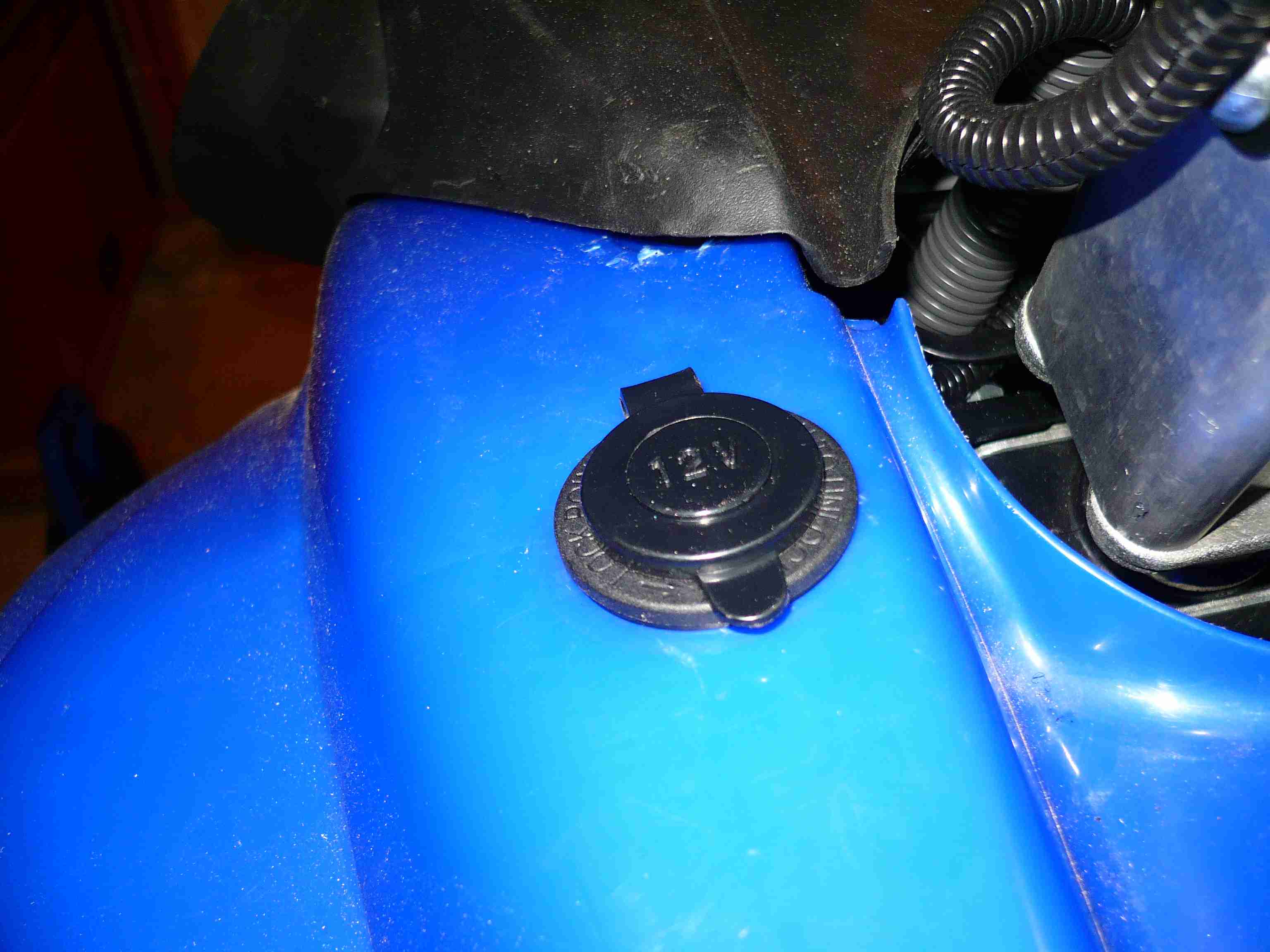

Instead of paying $73 CDN for the Yamaha 12 volt outlet, the Ski Doo one fits perfectly (PN 861507200). Cost was $30 CDN. I just cut off the factory connector on the sled and soldered it in with spade connectors so I can disconnect if required.

nice find - i'll have to find one on e b a y

Did you get it from Enns Brothers?

I did. When I called they said they had many in stock - Lagimodiere location.
RoicIND
Mine came from Wally-World for under $12....
$11.88 if I remember correctly....
