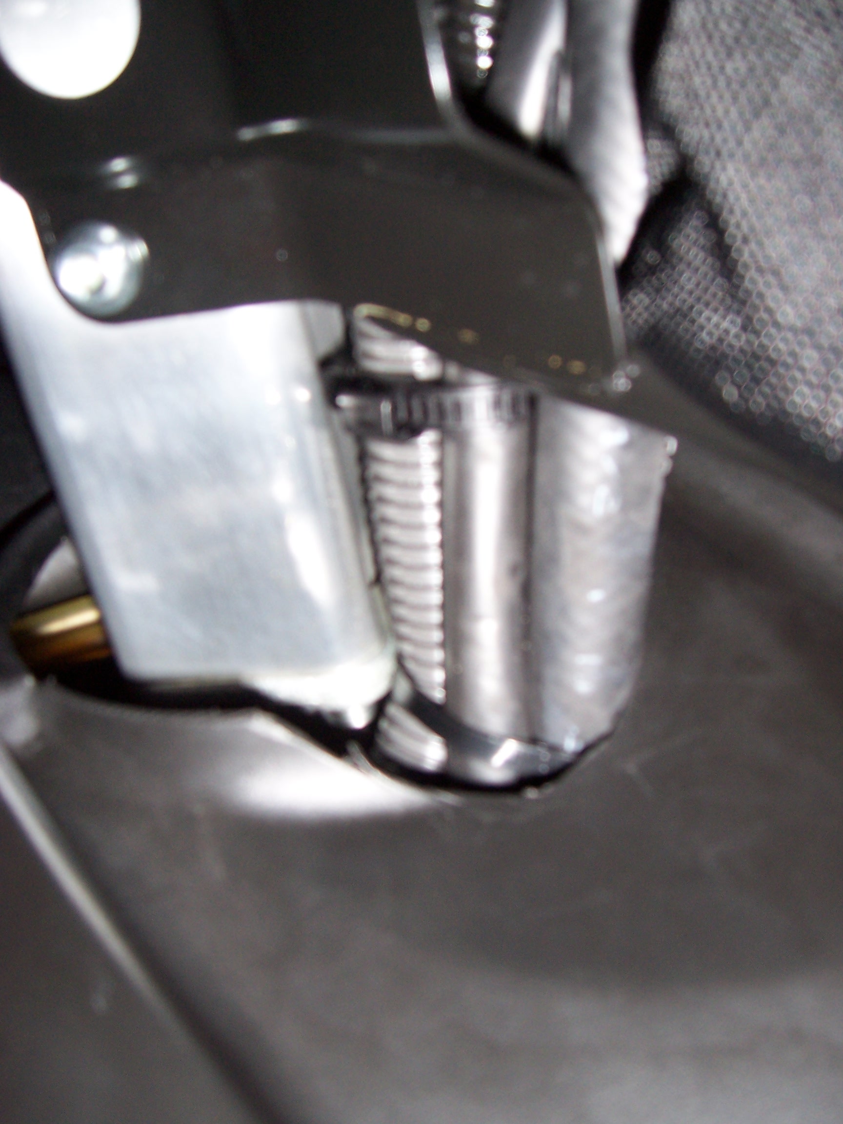

Ok here ya go it's pretty simple, I had to cut the plastic a bit by the riser so the tube has room to move back and forth with the steering. I forgot to look but I might still have the K&N package with part number but any parts store should be able to order you one! I think I used 5/8" I.D tubing but double check me by measuring as it was last year when I did this mod! So the pics, ask if you have any other?????? OH ya I found this rubber plug to cover the hole in the air box as the tube inside is gone and the hole is above the filtration! hope this helps you guys out!

Thanks for the info and pics; I'm trying to get a picture of this. So you just pulled the tube out of the airbox and closed the hole? Was the hose long enough to reroute to the riser or did you have to join a piece? And, the filter fits inside the hose? Is that a filter like one that would go on the end of a fuel line?chad450r said:Ok here ya go it's pretty simple, I had to cut the plastic a bit by the riser so the tube has room to move back and forth with the steering. I forgot to look but I might still have the K&N package with part number but any parts store should be able to order you one! I think I used 5/8" I.D tubing but double check me by measuring as it was last year when I did this mod! So the pics, ask if you have any other?????? OH ya I found this rubber plug to cover the hole in the air box as the tube inside is gone and the hole is above the filtration! hope this helps you guys out!

Yes I pulled tube out of airbox and closed the hole. I got new rubber line and ran it from top of oil tank up to riser and added a K&N mini air filter they use these on valve covers and small engines it is washable I have never had an issue in 2000 miles with this mod, the tube fit inside the bottom of the air filter then I added a clamp. Some people have said they would worry it might freeze but like I said 2000+ miles and no issue. If you roll over on side i have never had oil come out upside down might be a diffrent story but I got really tired of cleaning the airbox. Hop this helps
