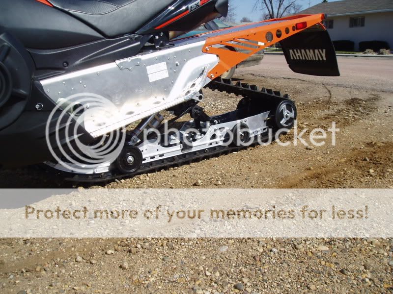

144" Tunnel extension using GYTR parts and making our own aluminum plate to fill in the hole 14.75" wide x 18.25" in length overall.

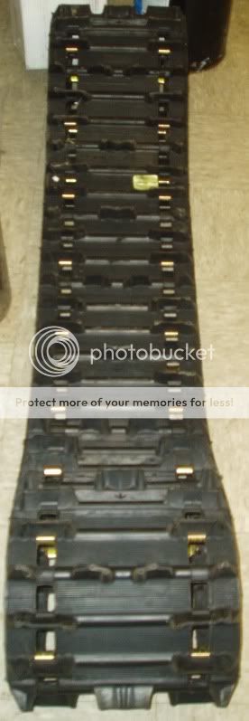

13.5 x 144 x 1.25 Camoplast Track!
OFT Racing 144" Phazer Rail Extensions (these incorporate a 6* kick up just like the FX Nytro XTX)!

that track looks bigger than 1.25 ???

With my experiance riding the mtx as a crossover sled, I think the stock kickup was enough, I have rearly ever had it plow through corners. With rail extentions I guess it probly is cheaper than the phazer rails. Interested in that track, quality, price, and thoughts on it.

The track is an out dated part number which I don't believe is available any longer. I did add a set of small wheels at the front of the rail where the stock hyfax were wearing and then another set of wheels where the stock axle would be as well.
