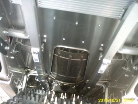

Banks93 said:Does the apex SE have the same issue as the XTX?
Here is a pic of my SE. IT looks like it will be fine for stud clearance.

Plenty of stud clearance there. Track is very close to the protectors just like it was with the last Apex's. I don't see a problem. Everyone getting all worked up over nothing.
