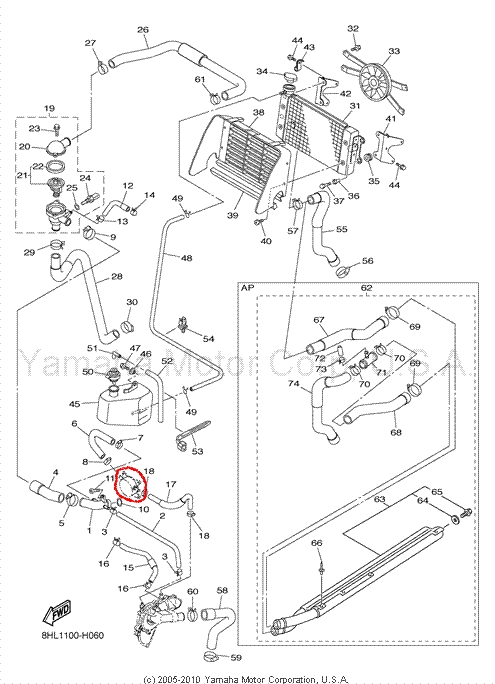

mach9
I'm looking into this temp gauge option also.
But I want to mount the sensor lower in the system to get a closer to motor reading.
mach9
SledFreak said:I would still like to know how to get my sled to run at 160 degrees....
This spot on the micro fiche says oil cooler.
Why do they call it an oil cooler?
It's hooked right to the cylinder wall.
