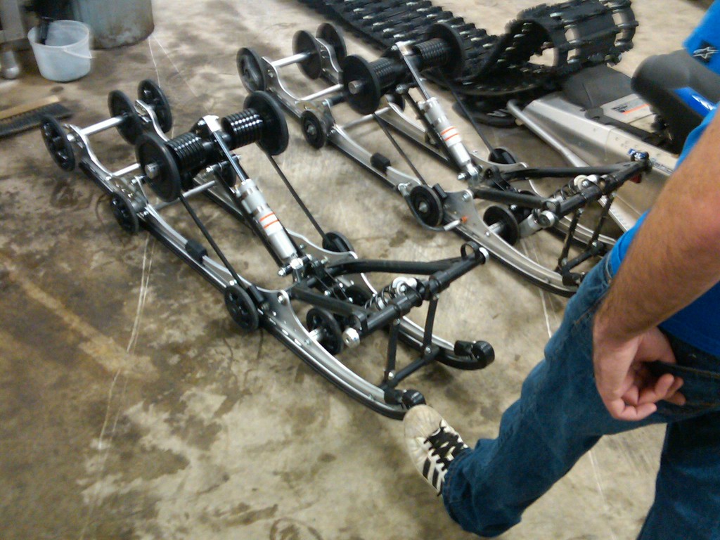

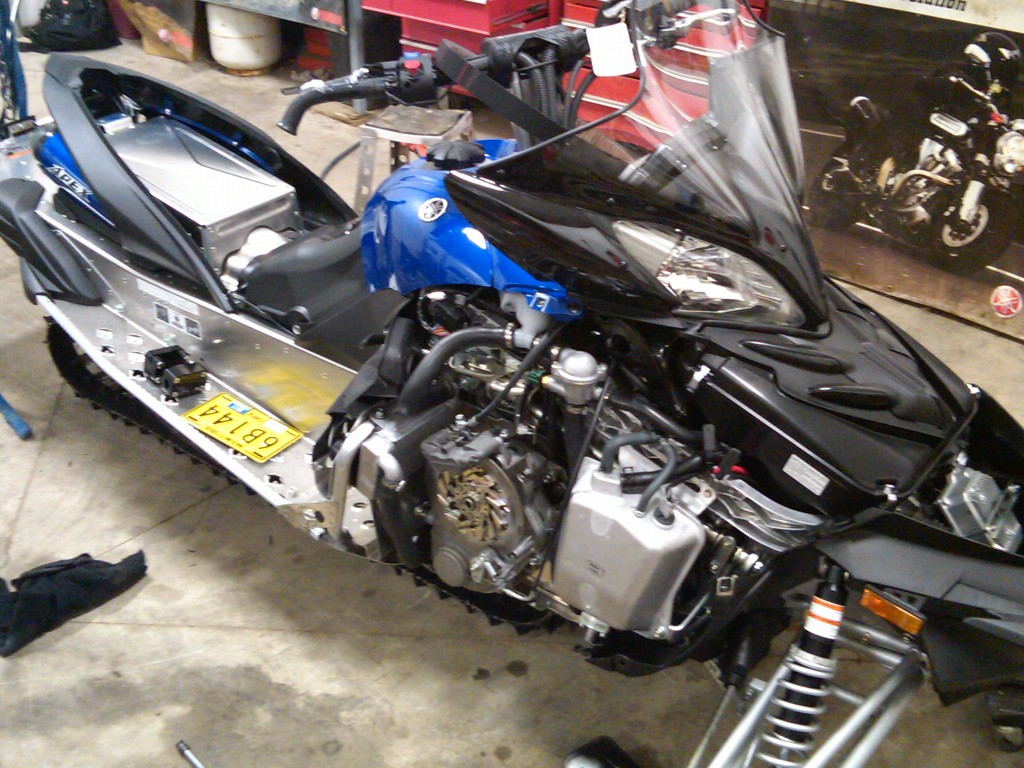

Getting my apex xtx ready for the shake out cruise this weekend.We got dumped on with a lot of snow!
The nytro xtx suspension & apex xtx skid look pretty well much the same. This thing better be good in deep snow. Approach angle measures the same so no reason it should not.
Anyway
Swapping ripsaw for Cobra track
Lake effect 2.5" riser
Yamaha mountain strap
USI vx 301 skiis
Should be ready to rip on Friday!

My cobra is getting swapped out from my 09 xtx nytro. The track had been tortured for 1900 miles & it still looks great. This track is a very good do everything performer.
