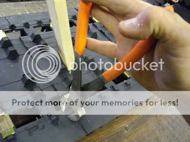

that or take 5 minutes and clip the little nubs and have WAY stronger drivers from Avid....
this little tool...
this little tool...
mtdream
Is in the Ttabs thread...here is link to page..
http://www.ty4stroke.com/viewtopic.php? ... &start=240

<------Must be slow. It took me 10 minutes to do my track.... Dammit!!!!akvector
I USED A FILLET KNIFE!!!
