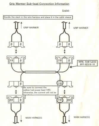

the hand warmers on my attack dont seam to get as warm as the older sleds is there anything that can be done to fix this? thanks
Yamaha had an update for this, new bars and a small harness. The updated bars have a different element that extends full length to cover the hooks too. I found a kit for 20 bucks. There is also a product called the Yamaheater. This combo works great.
06 bars with 07 or newer harness.HOT HOT

myrodman said:the hand warmers on my attack dont seam to get as warm as the older sleds is there anything that can be done to fix this? thanks![]()
If you're comfortable with wiring you can just rewire to series from parallel. I took the pins out of the connectors with a paper clip and moved the wires because I didn't want to cut/spice. The bars will be HOTT!! afterwards you will never need any setting over 50%. You should have an unused hot and ground lead coming from the main harness when you get done. There was also a harness sub-lead that accomplished the same thing not sure if it is still available.
