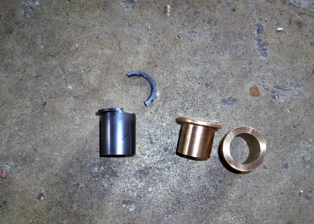

OUCH. nobody wants to find that.
that 2nd pic with those cheap plastic bushings are a joke. i broke 1 & bought 2 new ones & broke 1 just putting the skid in.
i said f%_k it & made some.
tensioners, i just used a big drill bit to take the heads off & once all are done, just hit it with a hammer. won't need them anymore anyways.

They slide off shaft if your lucky.I ended up wreaking one of my wheels getting it off though.Your rail broke at small wheel makes me real nervous.Sorry to see that.
