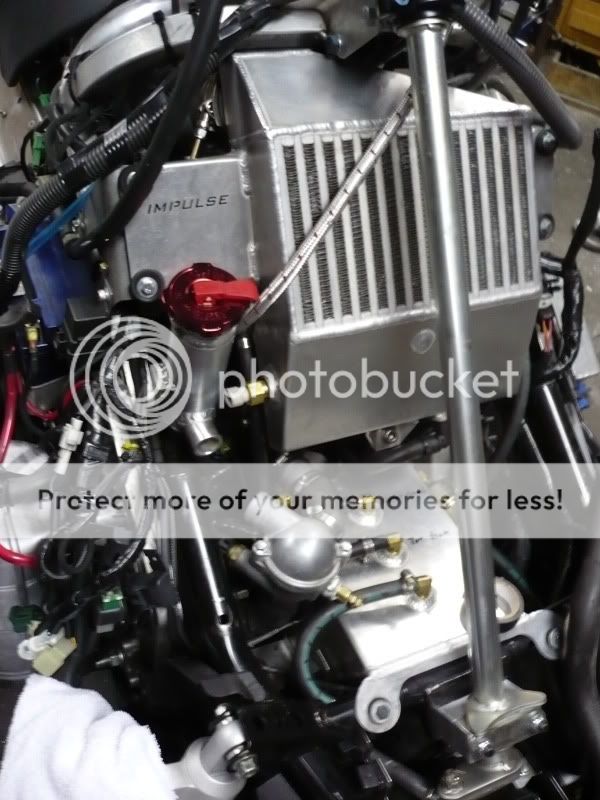

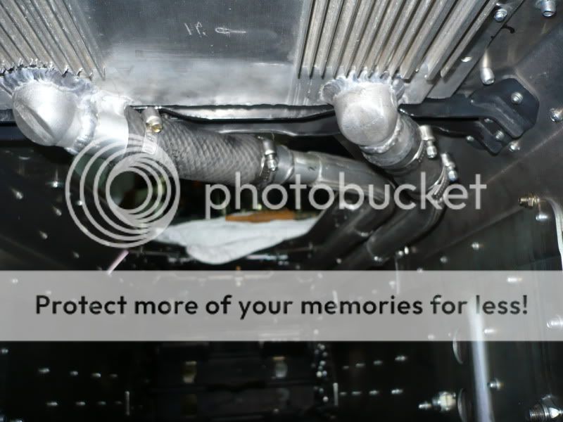

I did make my own kit:
yooper1
Very nice job! I hope the ones i bought turn out as nice as what you did.
You could sell those! What do you think you have in "your" kit?

Anymore pictures? That is Awesome!

That's what I did with my under tunnel exhaust. Cut it and turn the pipe 180 degrees and it works perfect.

Just finding this thread now. You rotated the header and tig welded. What kind of filler rod did you use? I know the header pipe is some kind of magnetic steel, but it doesn't appear to rust...cheap stainless??
Working on similar project and would like to do the same.

bradthebest
I just hit mine with the mig . Same wire i use for mild steel
Id use 309 stainless filler, mig would work fine with the right gas and 309 as well. Not that you couldn't get away with mild steel wire but I have had a weld crack due to it before costing me a turbo on a Harley, 309 should be a safe bet.
Excell is very easy to adapt to under tunnel as well and that is 304 Stainless so you know what your dealing with.

Had shop tig weld header, not sure what rod they used but do know it was stainless.
Exhaust was super quite at first and did get louder after awhile. The beauty of this setup, exhaust is tuneable.
