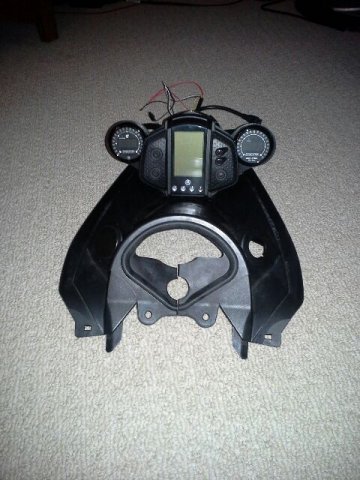

Just picked up an innovative AFR and Boost gauge, liked the innovative boost gauge as it is a higher resolution gauge. 6.6 psi not 7 psi. Just mounted them both on the duel gauge mount from Hurricane performance. Very happy with how it looks.
Looks awesome!! I changed mine to white face since the Apex is whiteish
