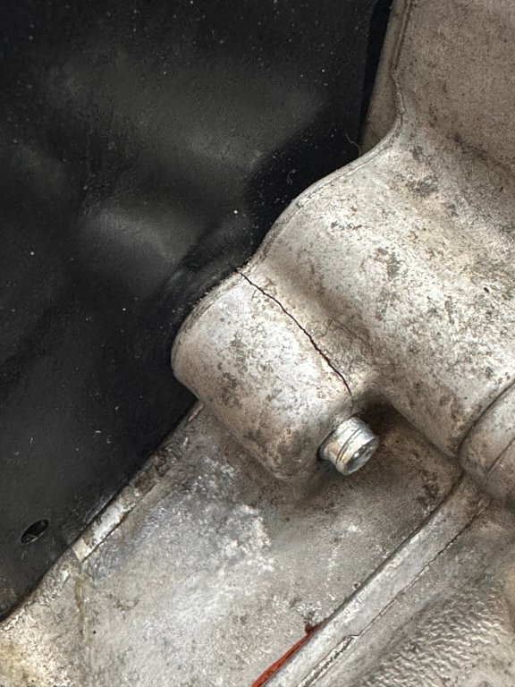

1. There is a crack on the inner chaincase, it had to be there from factory? Under 300 miles on this 2020, no signs of a hard kit from underneath? I know my xf7000 had a crack on the outer cover but not on the inside mounted to frame. I'm thinking it's fine and could thru bolt it if it's an issue. Anybody else seen this?

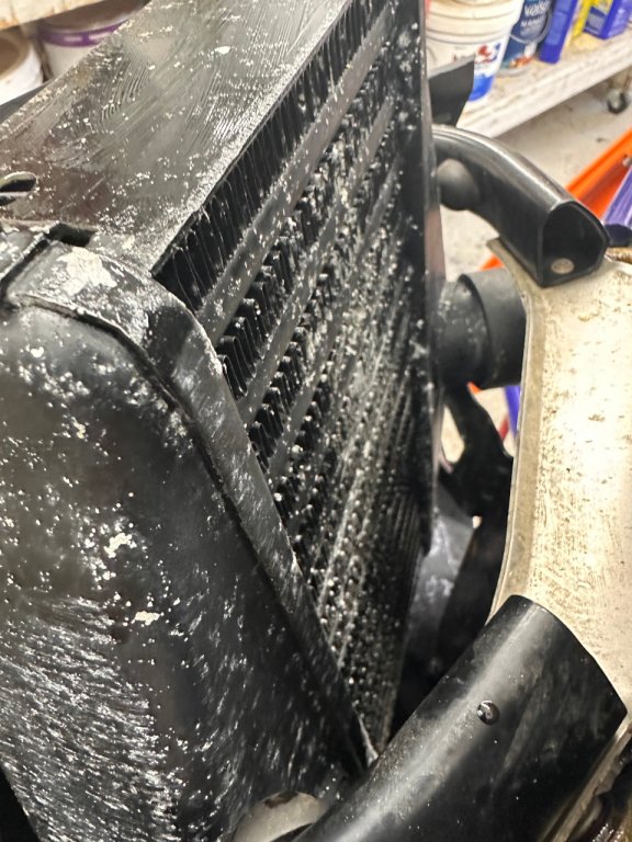

3. The Radiator got trashed from the PO trailering uncovered in the salty roads. It's got the typical aluminum white powder "cancer". I washed the entire sled down and made a baking soda paste with tooth brush to gently scrub all sides, then rinsed it very well. Its still looking bad... any ideas/products on how to neutralize the corrosion?

These don't have radiators, it's the intercooler. Shame some don't care enough to keep them up. Try a spray like Rust Check.I'm just about finished my tear down to install all the fixes and noticed a few things.

I’d just clean the Intercooler real good and re paint it black

Try some aluminum wheel cleaner on your aluminum parts.
Vinegar works also but will discolor some metal.

I'd be considering the crack in the chain case. Not sure if it can be repaired by a magnesium welding specialist?!?! Idk.... Order a new one or just leave it?!?!

Definitely nothing switched. I'm going to keep an eye on the case but I'm thinking it's going to be fine. They're under $300 so it's not the end of the world for me. I just can't wait to start putting it all back together with the BOP parts and everything else I've grabbed to upgrade it.Yes, most do it to sell console/tune as a package. The trade off is they can sell their sled, and appears never to have been tuned.

That shift fork could have been destroyed at a high speed reverse shift after a few rounds at the local pub. All the mold and salt damage could happen to a brand new sled if stored in the wrong conditions. As far as the chaincase crack? I doubt this happened from the factory or we would have had this reported before on this site. Most likely the owner knew that something was wrong and over torqued the cover after taking it apart and had no clue what he was looking at. That said, they are all easy repairs and with a little elbow grease she should clean up nice.

It's not the outer case that's cracked. This is the "inner" case that is bolted from inside the tunnel supporting the drive axle.That shift fork could have been destroyed at a high speed reverse shift after a few rounds at the local pub. All the mold and salt damage could happen to a brand new sled if stored in the wrong conditions. As far as the chaincase crack? I doubt this happened from the factory or we would have had this reported before on this site. Most likely the owner knew that something was wrong and over torqued the cover after taking it apart and had no clue what he was looking at. That said, they are all easy repairs and with a little elbow grease she should clean up nice.
