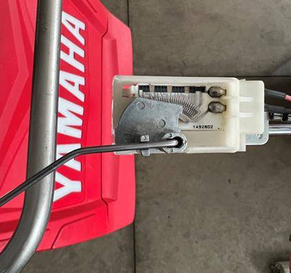

Case in point, I realize you already tested with a meter the fuel sending unit but as I mention, did you remove the clip holding the arm you are moving on the sending unit to the FULL or EMPTY position to expose the circuit board it travels along and clean with a piece of emery cloth? When I used the meter to record the readings, I didn't just do it at the FULL and EMPTY positions; I also measured as I moved the arm along its path from the empty to the full position. That is how I found there were bad spots on that board. When I removed the clip holding the arm and cleaned that section of the circuit board with a piece of emery cloth, I was able to get accurate readings in places I was not able to before (ie. from the 1/4 tank position to 1/2 tank position) but ultimately, there ended up being a short at the EMPTY position and hence why I had to order a new one.

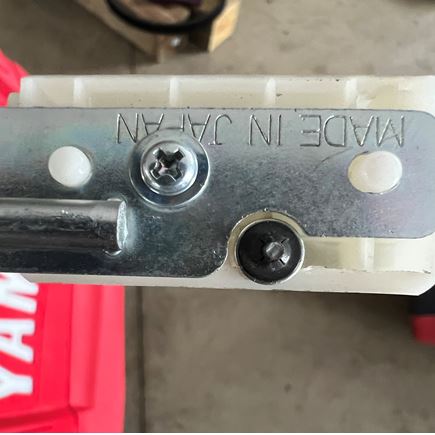

Yes, on the back side of the fuel sending unit is a clip with a washer below it. I just used a small flat head screw driver to get up underneath the washer and gently pry up to lift clip off its peg to allow the arm to be removed:

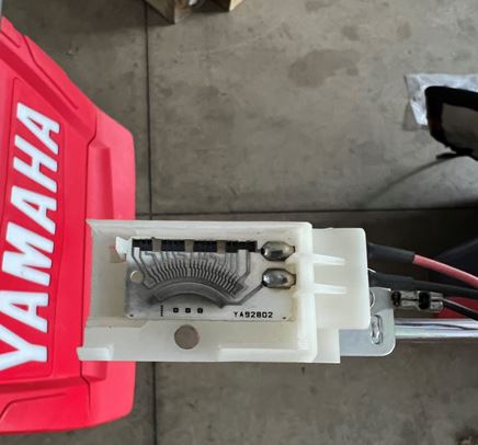

Once removed, you will see the track where the arm moves along that can be cleaned with an emery cloth. Also, there are contacts on the arm itself that can be cleaned up. When cleaning those contacts, if you apply to much pressure, you may have to reposition them to their upright position. You just want to ensure they are not flat as once assembled, those "brushes" (for lack of a better term) will not make contact with the circuit board:

Did exactly what you suggested and now working, thanks so much. Prior to putting the sending unit back in the tank, I fired it up and put the computer in diagnosis mode. Moved the arm open and close, the ohms were following the position. Is it possible the gauge reads in increments of like maybe 5? Not sure if I'm clear on that question.Yes, on the back side of the fuel sending unit is a clip with a washer below it. I just used a small flat head screw driver to get up underneath the washer and gently pry up to lift clip off its peg to allow the arm to be removed:
