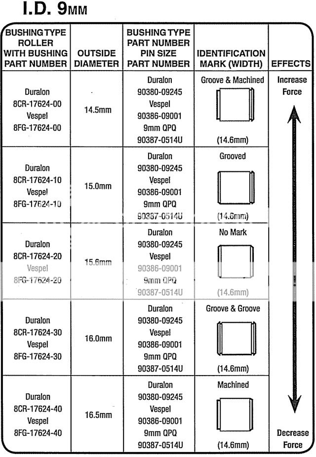

I'm looking up part Numbers for yamaha clutch rollers. I find five different part numbers. 8fg-17624-00-00
8fg-17624-10-00
8fg-17624-20-00
8fg-17624-30-00
8fg-17624-40-00
Just wondering what sizes go with what numbers. What is the 14.5 roller what is the 15.6 roller.
