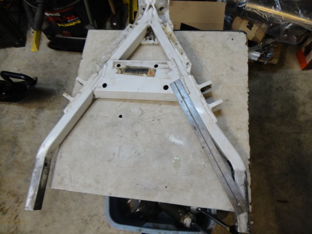

I did. Is write up somewhere here. Job went well. Don't skimp on parts. If it's even slightly bent replace. I hit something on a railroad grade completely severing the lower right arm off. Bent subframe good to. If I did it again I could do replacement in 5 hrs easy. Highly recommend a air rivet gun and just get every rivet and bolt holding front on. Also the stock skid plate from exchanger all the way forward. I may have never downloaded pics of it all apart but will try to in a few hrs. It's not a big deal. Looks way worse than it is. When done my alignment was even perfect. Good as new.

My father caught the right side ski bolt on a bridge last season, bent the lower a arm pretty badly, riding maybe 10km/h. Put a new a arm in it but it wouldn't handle right hand turns well. We measured side to side, right side spindle was 1.5" back!! We're both mechanics, ended up replacing the lower "sub frame" section at home in the garage. In all honesty, it wasn't the hardest job in the world, took us three nights after work from start to finish. Had to remove both upper and lower a arms, steering linkage, front radiator. Drill 30 or so rivets, have the remove the stamped steel portion of frame off the front. Basically you will have the front end stripped down to the engine for removal.

Yup mine bent same spot.
I didnt have to totally remove radiator so no coolant drained but yes its pretty much that order. Airbox,Get Rad loose,Remove arms and shocks,Remove Bulkhead,Remove steering stem then remove lower frame. The part that costed me most time was not replacing the factory skid from exchanger forward. Guaranteed its not straight if frame is bent. If not perfectly straight all the rivets wont line up on bottom. Only costs $11 and I dicked with that for over a hr trying to get it straight, New one all rivets lined up perfectly.

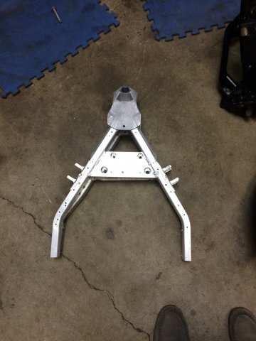

I see there is an updated part for the sub frame and air box. I ordered them we will see what changes were made.
Mine was updated subframe. Few extra holes not used were there. Also dont forget the two Rivnuts on bottom of subframe. They are needed if you have a skidplate and cannot be installed once the alum skid is riveted to the subframe. That was another half hr oops I did!
